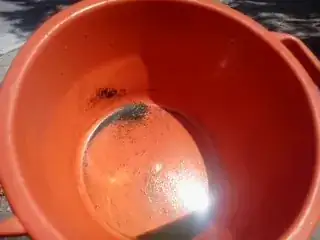

This is a continuation of my excessive coolant expansion question regarding my 98 Mazda 626 2L. When I drained the coolant I noticed this black sediment which settled to the bottom of the container I was draining into:
It seems to be fine grains of iron. I also got some almost BB sized chunks when I backflushed the heater core.

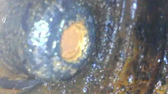

I took a picture of part of the water pumps' impeller when I swapped out the thermostat a few months ago ( using an endoscope ):
I don't think it could have fallen apart in the few thousand kilometers I've driven since then.

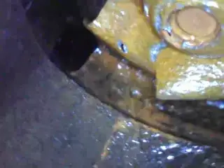

So @vini_i was right:
There be not a single fin left on the impeller! I bet allot of those little pieces of metal I was flushing out of the system where the remains of the impeller blades! I even cranked the engine a few times to get a visual of the impeller spinning, and all that's left is one tiny little stub of one fin.
Reviewing some video I took after I vinegar flushed the system a few thousand kilometers ago it actually looks like the flush took out some of the fins and I've been running with only one or two fins, which have finally given up the ghost.
Arghhhhhh!!!!!!!!!!!

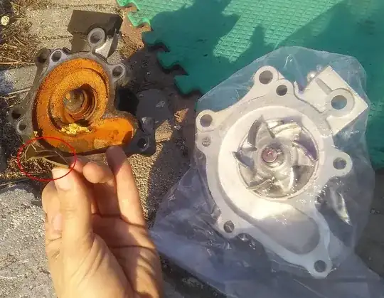

So I pulled off the old water pump and look what I found:
The fin in my hand was what I saw last year with my endoscope. It was sitting in the bottom of the water pump and just fell out when I opened it up. I have a strong feeling that this is the original OEM water pump that came with the car.

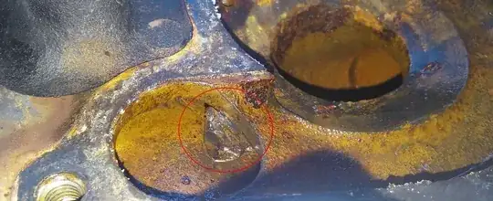

But guess what else I found:
Another fin jammed so hard in the water passage that I had to extract it with needle nose pliers. Now I'm wondering where the heck the rest of those fins are!
