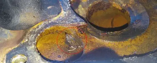

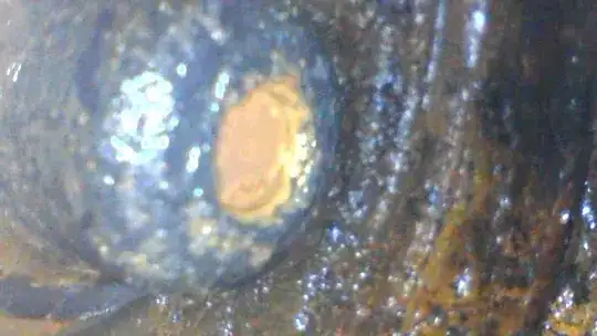

What I did to diagnose a problem with the water pump on my 98 Mazda 626 was to drain the coolant, remove the thermostat and use a cheap PC based endoscope I got off Amazon to visualize the water pump impeller. I disconnected the fuel pump and relived fuel pressure, inserted the endoscope via the thermostat housing until I could see the impeller, then while taking a video, cranked the engine a few times to make sure I could see the entire impeller and see how it was moving:

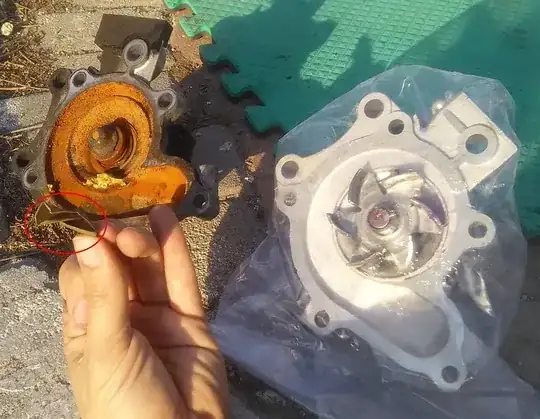

What I saw when reviewing the video was that all the impeller fins had disappeared! This was verified when I removed the pump:
I found on of the fins in the bottom of the water pump as can be seen in the picture. I also found another fin jammed into the water intake passage so firmly that I had to remove it with needle nose pliers:
I have a strong feeling that whatever is left of the rest of the fins are probably jammed deep down in the water passages somewhere.
