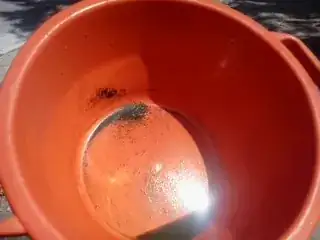

  3. The next thing is to check that coolant you drained. Slowly, decant the coolant from the container you drained it into into another container. Do you see any crud in the bottom of the container, maybe something like this: enter image description here If so, you may have a clog as mentioned above. Try back-flushing the radiator. Reinstall the thermostat, then stick a water hose in the fill neck, while opening the drain plug. Make sure to put a clean container underneath to catch any crud that might come out. You reinstall the thermostat to make sure the waters only path is backwards through the radiator. If no water flows, or very little, it may be so badly clogged that it will need to be taken to a shop to be removed and manually cleaned, or replaced. If water flows, and a bunch of crud is flushed out, that might solve your problem.
