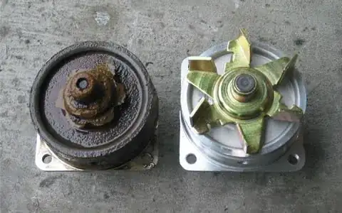

EDIT: @Paulster2 was kind enough to post a picture of what happens to a water pump when it is run with straight water without the corrosion prevention of coolant + water:
A rusty-ass water pump vs. a brand new one
I submit that the one on the left can no longer be considered a pump.
