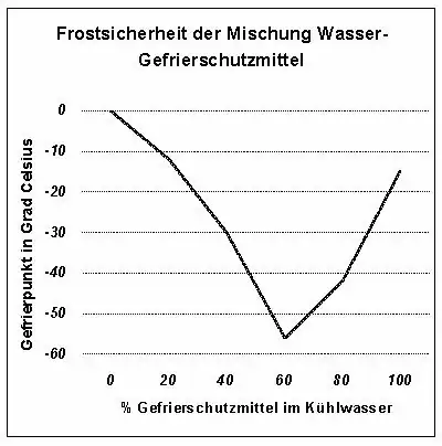

Reducing the freezing point
Well, this is obvious. While pure water freezes at 0°C, ethylenglycol can put it down to -55°C for a 60:40 (6 parts antifreeze, 4 parts water) mixture. However, it's interesting that the freezing point goes up to -15°C again, if you add more antifreeze:
(Sorry for the german. x-axis: fraction of antifreeze in %. y-axis: freezing point)

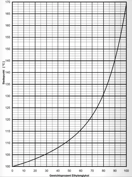

Increasing the boiling point
This was already mentioned in the other answer. The 60:40 mixture increases the boiling point from 100°C to 115°C. This is not so much, but since 90°C is not an uncommon coolant temperature, this gives some extra safety margin. By the way, the cooling system is pressurized when hot, which increases the boiling point a little more.
(Sorry again for the german...)
