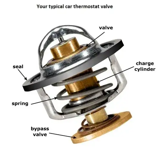

Typical Thermostat
Failure Modes
Mechanical thermostats fail in one of two ways:
  1. Stuck-closed
    The pintle/spring doesn't retract to permit flow at the set-point temperature that is usually stamped on the thermostat itself. which can lead to the engine running at hotter than expected.
    If hot enough, this can lead to serious issues such as a compromised head gasket or warped cylinder head.
  2. Stuck-open
    The pintle/spring doesn't actuate to maximize flow restriction at temperatures cooler than the set-point temperature. This usually results in the engine running at cooler than designed-for temperatures.
    Running an engine too cool can result in issues with the emissions and catalytic converter efficiency due to increased hydrocarbons in the exhaust.
Test Procedure
The thermostat needs to be out of the car and on the bench for this.
The temperature at which the thermostat opens is usually stamped on the thermostat itself. In the absence of such, a technical manual or parts supplier will require referencing.
Appropriate PPE is strongly recommended as this test involves boiling hot water.
  • Place the thermostat in boiling water¹:
    • if the thermostat opens, this confirms the thermostat is able to open
  • Remove the thermostat from boiling water²:
    • if the thermostat returns to the closed position, this confirms the thermostat is able to close
¹ - remember that the temperature of boiling water varies with altitude; it's 100 °C at sea level
² - now what did I say about PPE again?
