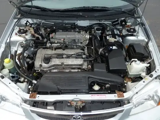

Test: The upper radiator hose seen here next to the right of the radiator cap
2000 mazda protege engine bay
should feel warm/hot when the car warms up. If it feels cold after a while it means that the thermostat is stuck in the open position. Replacing it is fairly simple but a bit messy (due to the coolant dripping out).
