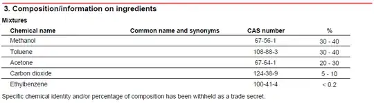

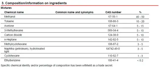

I have seen quite bit of traffic on the internet about the differences. As with what Steve said, there isn't much. A lot of the things which people are saying are things like: "Carb cleaner leaves a residue, while brake cleaner doesn't". I pulled the Data Safety Sheet for both of the CRC cleaners (trying to keep apples-to-apples here):
Carb Cleaner:
Brake Cleaner:
There is a lot less Toluene and Acetone in the brake cleaner than there is in the carb cleaner, so I can suggest there would be less of a propensity for these chemicals to hang around.
According to Google, Toluene is a colorless, water-insoluble liquid with the smell associated with paint thinners. It is a mono-substituted benzene derivative, consisting of a CH₃ group attached to a phenyl group. Acetone is a colorless, volatile, flammable liquid, and is the simplest ketone. I'm not a chemist, but believe either of these could leave a residue behind if left in sufficient quantities. Since the brake cleaner has much less of them, it would seem the parts cleaned with these would have far less of a chance to have a left behind residue. This seems to hold true with the internet gab going on.
