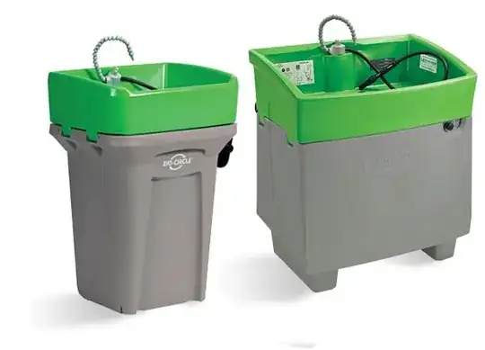

There is a new-ish product on the market called Bio-Circle. This is about as earth friendly as it gets.
The way this stuff works is there are live micro-organisms which ingest oils and other organic contaminants, turning them into water and carbon dioxide. The great thing about it is there bio-remediating liquids maintain their cleaning power over time (the micro-organisms don't readily die-off). If the solution sits for too long and the stuff does die off, you can easily get a recharge for it and it's back up to where it should be.
I know the physical footprint of this is probably a bit large for an apartment, but would work well for a small shop. I haven't found anything like it which helps you stay away from dangerous/toxic chemicals which are normally used to clean parts. Best of all, this stuff works great!
Here is a video of Jay Leno talking about it in his (in)famous garage.
NOTE: I have no connection, nor affiliation with the owners or makers of this product ... Just trying to answer the question honestly.
