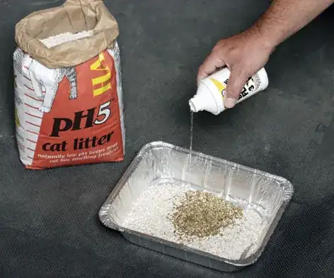

  • Brake Fluid - Easy if you have a cat. Pour brake fluid into a tray of cat litter and leave it in a safe, well-ventilated place. It will evaporate within a few days. Try to place it high if you have a dog as well because it may poison them otherwise. Brake fluid is alcohol-based. It's toxic when ingested. When bleeding brakes, catch the runoff in a jar. Brake fluid from a jar that's been opened for more than a few months probably has absorbed enough water to reduce its boiling point past the point of safety. It is a flammable fluid so you must keep it away from any sources of ignition! Well... unless you are trying to cause a house fire. I do not recommend that though.
    If you don't think you will need that much brake fluid, you can buy brake fluid in 8-ounce bottles instead of quarts to keep it from going bad so often. All goes towards my main point about only generating waste where absolutely necessary.
