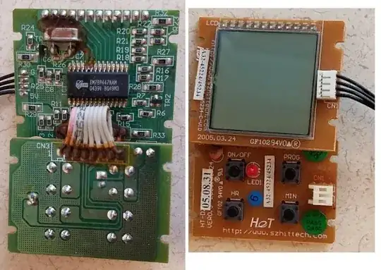

A Specific Example of a Microcontroller application
This is an image of a microcontroller board from an automated coffee maker. This appears to be a standard component for automated coffee makers manufactured in China. The web site for the manufacturer is printed on the PCB.
The image is composed of two views. The view on the left is the back of the board containing the microcontroller and supporting circuitry. The view on the right is the front of the board with the LCD screen and a set of buttons which are used to set the current time and to perform actions such as programming a start time, etc.
The view on the right fits into a carrier which then fits into an opening in the front of the coffee maker. The switches on the lower PCB are actuated with rocker arm switches. The LCD, which seems to be special purpose, is used to display the current time and status as well as to display the user interface when changing the settings of the coffee maker. The red LED is used to indicate when the coffee maker is actually making coffee and to indicate when done by turning the illumination back off.
The microcontroller is an ELAN Microelectronics Corp EM78P447NAM (datasheet) which is an 8 bit microcontroller. Some of the basic stats show what a small and minimal device this is however it works nicely for its intended purpose. The intent is to develop software which is then downloaded into the write once ROM as a part of manufacturing.
