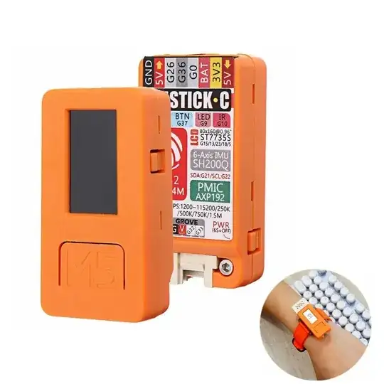

If you want a recommendation of ESP32, take a look at M5stack which is a modular system and allows you to easily combine (stack) devices and accessories (e.g device battery) and has a dozen or more sensors to measure many things. It is cheap (IMO) and easy to get to grips with, and I bought the lot, just to have a play. Once bonus is that you don't need to do any soldering or breadboarding (although you can); everything is plug 'n' play. You might be interested in the wrist “wearable”, which looks pretty cool & which I am using to track employees. See below for image
