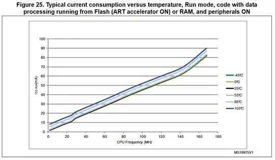

Using MicroPython you possibly could switch from the consuming Pi Zero to some other platform. The official PyBoard is an STM32F405RG which could be good enough but there is support for the low-power STM32L4 series as well.
Currently you are running a Pi Zero at 1 GHz to use an UART and an I2C peripheral to interface your SIM808 and LSM303. The Pi consumes around 80 mA in idle, not speaking of when it is not.
If you could lower your CPU clock frequency you could lower your power consumption as well. For this task a couple of MHz would suffice.
So you could change to a PyBoard which consumes only a couple mA under 10 MHz in run mode with all peripherals ON.
Much less 0.4 mA in stop and 2.4 uA in standby mode.
Possibly you would have to port your scripts to MicroPython but that would be easier than porting them to C.
