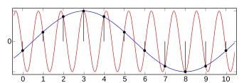

Aliasing is a digital sampling artifact, and is also in effect in your measurement (aren't you lucky!). Here's a borrowed image from WP:
Aliasing example.
As the analog front-end is only letting rise times 35ns to 40ns through, the ADC sampling bridge sees something like an attenuated 50MHz sine wave, but it's only sampling at 50MS/s, so it can only read sinusoids below 25MHz. Many 'scopes have an antialiasing filter (LPF) at this point, which would attenuate frequencies above 0.5 times the sample rate (Shannon-Nyquist sampling criteria). Your scope doesn't seem to have this filter, though, as the peak-to-peak voltage is still fairly high. What model is it?
