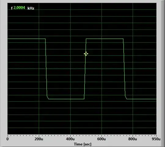

Next we have 2 kHz: 2 kHz square wave
Here we see a bit of distortions.

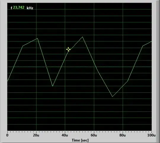

Here we have 28 kHz:
28 kHz square wave
We're getting spikes now.

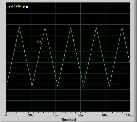

48 kHz:
48 kHz square wave
We're at half of the sample rate now and the frequency is getting bad.
