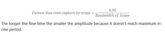

I'm still not sure how it's related to my circuit. For example, I'm using a crystal oscillator of 32.8 MHz, so do I need bandwidth more than that? Like 40 MHz+. How is the frequency relevant to the BLE antenna circuit on the PCB?

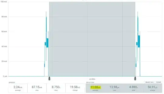

Edited : I need this kind of waveform with measured currrent value over the sleep cycle.
Use a Timer as a wake-up source This is how to wake up the ESP32 that consumes the least power. Only the RTC Timer is on. It is a counter that triggers an alarm (like an alarm clock) whose period is configurable. enter image description here Consumption of 11.5µA in timer mode powered by 4.2V

The current consumption waveform you show as an example doesn't need a high bandwidth or a high sampling rate.
Several hundred samples per second would be fast enough for that kind of plot. At those speeds, a datalogger would be enough.
Pretty much any digital oscilloscope would be fast enough for that task
More important is that the scope needs to be able to hold a lot of measurements so that you can be sure of capturing the entire power cycle. Again, any modern digital oscilloscope should be up for it.
