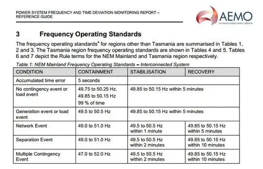

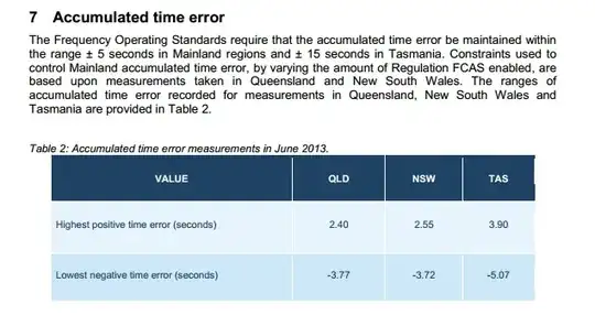

In Australia, the interconnected grid frequency is held to a nominal frequency of 50 Hz, to be within ± 0.15 Hz 99% of the time. The accumulated time error may not be more than five seconds.
Excerpt from the AEMO Frequency Report Reference Guide:
The various Australian power utilities do a pretty good job of maintaining the target frequency and accumulated time error within the stated limits. AEMO publishes reports on this monthly - for the month of June 2013 the accumulated time error in Queensland varied between + 2.40 and -3.77 seconds.
From this, we can conclude that the 50 Hz power system frequency is an OK clock signal - but only so long as your time-keeping device has uninterrupted access to the power grid!
