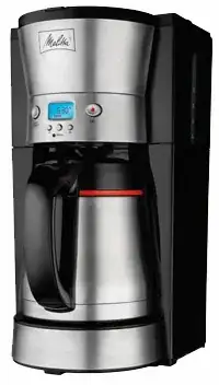

I am in the military, stationed in Djibouti, Africa. We generate 240V/50Hz power on base, but some buildings also have 120V outlets, which I assume is transformed somewhere else on base, probably at the diesel generating station. I also assume that it is 50Hz as well (see below).
We just received a new coffee pot with a 120V plug and a clock/timer:
Melitta Coffee Pot with timer
After two days of setting the clock, hoping for hot coffee when we arrive at work, and finding that the time on the display was incorrect, I realized that the clock is probably 5/6 slow due to the fact that the power is 120V/50Hz instead of 60Hz. A bit of timing confirmed that the clock is, indeed, ten minutes slow every hour.
I would have thought that the internal clock would be a simple quartz clock running off rectified DC, but that wouldn't (I assume) affect the frequency of the crystal. I'm guessing, then, that the clock is a different A/C circuit.
Is there a reason (cost?) that the clock relies on a 60Hz signal?
