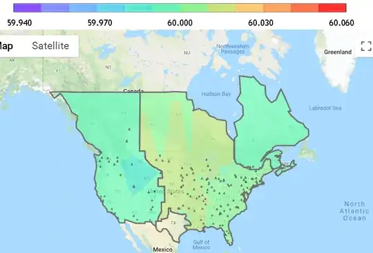

Frequency of AC power grid in North America is monitored by a network of Universities. You can see the live gradient map at FNET here in real time. It is maintained to about 0.1% across the continent.
However, this doesn't look like having any relevance to accuracy of impeller-based water pump, since the flow will depend on pressure differences and viscosity. Maybe a peristaltic-based pump might give you some accuracy proportional to AC mains frequency, but it will give you a constant flow rate, so it is totally unclear what you are trying to measure.
