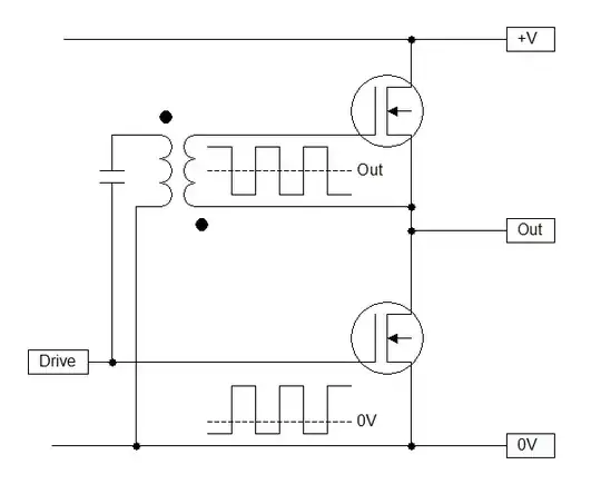

The high-side FETs - these are source followers and I'm presuming it's because you can't find a P channel that does the job. A little bit more care needs to be taken driving these because the source is following the output. I'd be tempted to use a transformer to provide an isolated supply for those FET drivers and use a really fast transformer for transferring the drive signal up to that circuit. Again, taking the gate negative when turning off is needed I believe.
Here's a rough sketch of how you'd drive the source followers with just a drive transformer, although I think you'll need a power transformer and driver as well as just the drive transformer: -

    Could you elaborate on the transformer idea? I haven't heard of transformers driving a FET. FWIW, the parallel MOSFETs are for the full-bridge that I asked about a few days ago, which you answered. – Saad Jul 17 '13 at 20:51
  • For the top FETs, the drive to the gate, in order to keep the FET on has to be x volts above the source - as the source is also the load voltage, it makes the gate voltage drive non-trivial from the viewpoint of ground/0V. This means you need to raise the gate drive (relative to ground) to the same potential as the source and of course this is a little tricky so I'd "float" some power up to the top fet's source via a transformer so that the driver circuits were driving a gate voltage relative to the source (output voltage) BUT I need also to couple the gate signal up there too. Makes sense? – Andy aka Jul 17 '13 at 21:33
  • Hi @Saad yes, I remember!! This is going to be a tricky one but gut-feeling tells me it's going to work. Can you not find P channel FETs for the top transistors? – Andy aka Jul 17 '13 at 21:35
    no, digikey doesn't return with P-Channel MOSFETs for my parameters. I'll look again. Question: Why not just use a gate driver IC? Why 'bother' with a transformer? – Saad Jul 17 '13 at 21:46
  • Andy, would it be possible for you to give me a rough schematic for this? Googling "Transformer Driving FET" doesn't return much. – Saad Jul 17 '13 at 22:24
  • @Saad you are missing my point - the top FETs are wired as source followers and this means the source voltage follows the gate voltage (no voltage amplification) and, if you want the top FETs to switch on efficiently your gate drive signal has to rise and fall relative to the source. – Andy aka Jul 18 '13 at 07:18
    @Andyaka half-bridge driver ICs are really common, and these provide a floating drive voltage for the high-side, N-channel FETs. Usually it's provided through an external capacitor that's charged through a diode when the low side is on, so essentially it's a charge pump. I assume this is the kind being considered. Since the gate is driven relative to the source, they really aren't source followers. – Phil Frost Jul 18 '13 at 12:25
    For a discrete example of a floating high-side gate drive, see this previous answer of mine. Integrated driver ICs that do the same thing are common; you just supply the bootstrap capacitor (C13). – Phil Frost Jul 18 '13 at 12:28
  • @PhilFrost it looks a good design. I was using the transformer conceptually to help the OP understand that you just can't activate the top FETs with a 0V based drive signal. – Andy aka Jul 18 '13 at 14:54
    @Andyaka I understand now! I was confused because I actually did know that the gate voltage needs to be above the source and not 0V and so I wasn't sure why you mentioned it; I thought I had missed something when you mentioned a transformer! But yes, I do intend to use a Gate Driver IC! – Saad Jul 18 '13 at 14:58

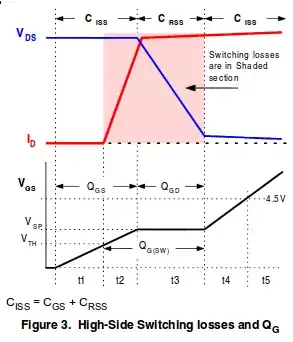

You can make an estimate of the switching loss (of each of the top FETs) by using:
\$P_{\text{sw}}\$ ~ \$\frac{I_o f_{\text{sw}} V_{\text{in}} Q_{\text{sw}}}{I_g}\$ Where \$I_g\$ = \$\frac{V_{\text{gmax}}-V_{\text{pl}}}{R_g+R_{\text{driver}}}\$ and \$V_{\text{pl}}\$ is the miller plateau voltage.
So, \$P_{\text{sw}}\$ ~ \$\frac{\text{(110A)} \text{(12V)} \text{(30kHz)} \text{(135nC)}}{\text{0.94A}}\$ = 5.7W

What's letting you down here is the speed of the rise time(Tr) of the AUIRF1324S-7P which is a massive 240ns.
I can think of a MOSFET that's in a package that can handle 240A, is silicon limited to 1000A, so any 5ns switching time where one FET is on before another will not damage the junction. It retails for less than $5 each on outperforms the AUIRF 5 fold in all speed measurements. You would only need two together to produce 500A.
You should check the actual gate current source graphs for the drivers because some that are averaged rated at 2.5A in the brochures have maximum ratings of 3.8A at Vgs max
Many of the drivers rated for 2A were only managing a max of 1.96A at Vgs max
