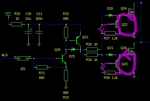

Here's a gate driver I made from discrete components a while ago:

The next thing to notice is that for both for turn-on and turn-off, the gate current doesn't flow through any resistors except those that I've intentionally placed to slow things down (R25, R26, R15, R16). This keeps the switching losses low and the MOSFETs cool.
Why would I want to slow things down? If the source-drain voltage of a MOSFET rises too quickly, this high \$ d V/d t \$ couples through the gate capacitance and can raise the gate voltage enough to turn the MOSFET on. In a half-bridge configuration, this happens to the side that just turned off as the other side is turning on. Accidentally, the side that just turned off is turned back on, both sides are on, you've basically shorted the battery terminals together, and bad things happen. International Rectifier explains it a bit more at the end of Power MOSFET Basics.

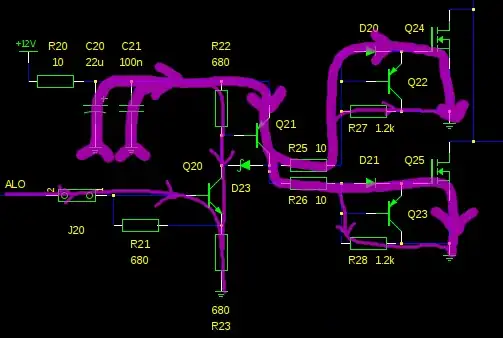

Turning on:
on schematic
A high input at ALO turns on Q20. R23 is placed in the emitter, rather than on the base, so that Q20 does not saturate, and will be quicker to turn off. R21 also helps with a quick turn-off.
Most of the current through R23 comes from the collector of Q20 (by virtue of a BJT's current gain). This current must also flow through R22, raising the voltage across Q21's base-emitter. This opens the flood gates for current to flow through the nearby decoupling caps C20 and C21 (or C13, on the high side), through Q21, R25, D20, and through the gate.
As long as ALO is held high, a small current flows through R27 and R28. This in turn creates the voltage that props up the base of Q22 and Q23, keeping them off.
Turning off:
off schematic
With the ALO voltage removed, Q20 is off, cutting off the current through R22, turning off Q21, removing the source of current for R23 and R28. The gate capacitance is now free to discharge through the base-emitter diode of Q22 and R27. The current gain of Q22 multiplies this current so the turn-off can be very fast.
