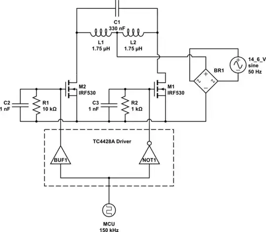

I am working on a inductor circuit to heat a workpiece. I have a working setup @12VAC.
In short I have the following elements in the circuit:
  • Microcontroller to generate pulses with a DC of 50% with its own power supply, sharing ground with the transformer powering the solenoid.
  • Two MOSFETs (100 amperes continues drain current, 150Vds) on the low side to switch the direction of the current through.
  • A 3570 nH solenoid of 11 turns, ~5cm diameter, made of copper pipe with 1 cm diameter. (Planning to apply watercooling through the coil some time later on.)
  • A 230VAC to 12VAC transformer that can deliver up to 35 amperes peak, or 20 amperes for a while.
  • A MOSFET driver (TC4428A) to drive the gates of the MOSFETs.
  • A10K resistor on each MOSFETs gate to source.
  • 1000pF ceramic capacitor on each MOSFETs gate to source (to reduce some ringing on the gates.) Vpkpk is ~17Volts on the gates.
schematic
The circuit shorts when I want to apply 48VAC to the circuit using a welding machine. The MOSFETs should be able to handle (48VAC = ~68VDC * 2 = ~~136Vpkpk). Nothing explodes, the MOSFETs are in one piece, but the resistance between the pins of the MOSFETS (gate, source, drain <-> gate, source, drain) are all 0 or very low (<20Ohms). So they broke down.
What caused my MOSFETs to break down? It is hard to examine the circuit when components die.

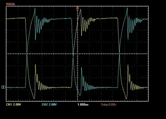

Ringing on Gates without C2 and C3, while solenoid was not powered. Sharing common ground
Ringing on gates without C2 and C3, while solenoid was not powered. Sharing common ground with transformer.
The wires from MCU to the TC4428A driver are, say, 5cm. From the driver to the gates, the wires are ~15cm. Does this cause ringing? Thick ~2mm wires where used from the TC4428A driver to the gates.

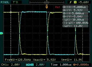

Snubbed ringing on gates with C2 and C3, while solenoid was not powered. Sharing common ground.
Snubbed ringing on gates with C2 and C3, while solenoid was not powered. Sharing common ground. Looks much better than the first picture.

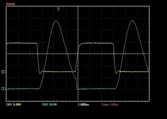

Ringing on Gates while solenoid was powered
Ringing on gates while solenoid was powered. Why is the ringing increased when the solenoid is powered on, and how can I prevent/mimize it while maintaining switching speed?

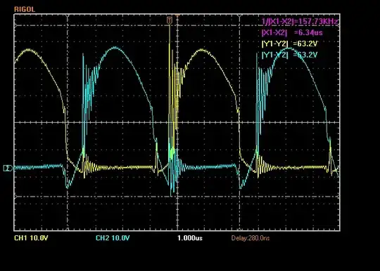

Measurement on Source to Drain with workpiece in solenoid @ ~150Khz
Measurement on source to drain with workpiece in solenoid @ ~150Khz. Shown in the last picture, if the signal was clean, it would yield a Vpkpk of ~41 volts, but due to the spikes it is around ~63 volts.
Would the latter of 150% over/undershoort Vpkpk be the problem? Would this result in a (48VAC => 68Vmax => 136Vpkpk * 150% = ) ~203Vpkpk? How would I reduce the noise on the waves measured on the source -> drain?

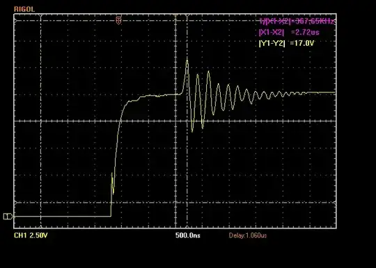

Here I disconnected one MOSFETs gate from the driver. CH1 is the gate, CH2 is the drain of the MOSFET that was still connected. Now both waves looks fine. No/minimal current was flowing here. When I do connect both MOSFETs to the driver, and measure the resistance between the two gates, it says 24.2K ohm. Could it be that if one MOSFET is turned off by the TC4428A driver, that somehow it still picks up a signal from the other MOSFET's gate when it is turned on by the driver? Is it a meaningful idea to put a diode like so driver --->|---- gate to make sure there is no noise? Preferably a diode with low voltage drop of course.

  • What the heck is that thing you labeled C1? It looks like it's meant to be a cap accross the two coils, but the center tap is tied to a third plate in the middle? Huh??? – Olin Lathrop Jul 08 '13 at 13:18
    Please don't add snubber diodes across the coils - this won't work - you can't use simple snubber diodes on a split winding coil. You need a diode and a zener. The zener voltage has to be above the supply voltage or at least no less than it. – Andy aka Jul 08 '13 at 13:33
  • I don't know how you start this circuit, but IMO applying the power without the square wave is an instant kill for the poor mosfets! Can't you include some safety by measuring the current, either the individual mosfet current or the total (aggregate) current? Next I would drive te mosfets with 2 separate signals, so you can keep them both disabled at startup, and fiddle with the pulse width. – Wouter van Ooijen Jul 08 '13 at 15:42
  • @WoutervanOoijen Because the MOSFET gates are grounded with R1 and R2, they do not conduct when the power is applied without the square wave. You are right about keeping them both disabled. The pulses only reach the gates when a relay is powered, I forgot to draw it on the circuit. – Mike de Klerk Jul 08 '13 at 17:35
  • As you have drawn the circuit either one gate or the other will be high at any one moment. – Wouter van Ooijen Jul 08 '13 at 19:51
  • Wow. @Phil Frost I clearly did not understand and made assumptions that were incorrect. I retract my "just a diode" comment. – Spoon Jul 08 '13 at 22:10
  • @OlinLathrop Its a funny way of drawing that part of the circuit I suppose. C1 is put parallel to the solenoid but is not connected to the + coming from BR1. – Mike de Klerk Jul 09 '13 at 06:08
  • Then -1 for misleading, ambiguous, and sloppily drawn schematic. – Olin Lathrop Jul 09 '13 at 12:39
  • @MikedeKlerk I'd suggest doing something to indicate that the inductors are mutually coupled in your schematic. CircuitLab I don't think has any tapped coil or autotransformer symbol, so just a text note would be good. When I first read it, I thought they were two separate (uncoupled) inductors, which really changes the meaning of the circuit. – Phil Frost Jul 09 '13 at 18:49
  • You may want to move the capacitors to D-S instead of G-S. Now they not only make the response worse, but may actually cause an overlap with that risky 50% duty cycle. I would, in fact, reduce that percentage, so that one side is reasonably well closed when the other turns on. – Zdenek Nov 10 '17 at 21:04

From the driver to the gates, the wires are ~15cm. Does this cause rining?
Almost certainly, and it's a fair bet that this is destroying your MOSFETs, by one or more of these mechanisms:
  1. exceeding \$V_{G(max)}\$ even for the briefest instant
  2. exceeding \$V_{DS(max)}\$
  3. simple overheating due to slow switching and unintended conduction
#3 should be pretty obvious when it occurs, but the other two can be hard to see, since they are transient conditions that may be too brief to be visible on the scope.
C2 and C3 are not decreasing the ringing. You get ringing on the gates because the capacitance of the MOSFET gate (and C2, C3 which add to it) plus the inductance formed by the loop of wire through the driver and the MOSFET gate-source form an LC circuit. The ringing is caused by energy bouncing between this capacitance and inductance.
You should put the driver absolutely as close to the MOSFETS as possible. 1cm is already getting to be too long. Not only does the inductance created by the long trace to the gate cause ringing, but it limits your switching speed, which means more losses in the transistors. This is because the rate of change of current is limited by inductance:

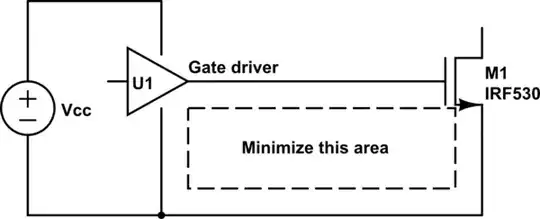

In addition to putting the gate driver close to the MOSFETs, you want to minimize the loop area of the path the current through the gate must take:
schematic
The inductance is proportional to the area illustrated.
The inductance limits the switching speed, and it also limits how well the gate driver can hold the MOSFET off. As the drain voltage on the MOSFET that just turned off changes (due to the other MOSFET turning on, and the mutual inductance of the coils), the gate driver must source or sink current as the internal capacitances of the MOSFET charge or discharge. Here's an illustration from International Rectifier - Power MOSFET Basics:

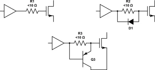

Get rid of C2 and C3. If you still need to reduce ringing after improving your layout, do that by adding a resistor in series with the gate, between the gate and the gate driver. This will absorb the energy bouncing around which causes the ringing. Of course, it will also limit the gate current, and thus your switching speed, so you don't want this resistance to be any larger than absolutely necessary.
You can also bypass the added resistor with a diode, or with a transistor, to allow for turn-off to be faster than turn-on. So, one of these options (but only if necessary; it's much preferred to simply eliminate the source of the ringing):
schematic
simulate this circuit
Especially in the last case with Q3, you have essentially implemented half of a gate driver, so the same concerns of keeping the trace short and the loop area small apply.

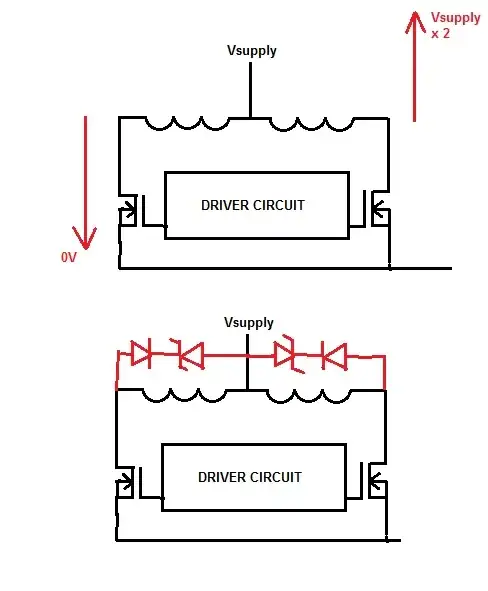

To correctly clamp the voltages on the FET drains to a reasonable value consider this: -
The natural operation of the two coils (if there is any significant magnetic coupling between the two coil halves) is to produce twice the supply voltage on each drain on alternate cycles.
It's like a see-saw with the midpoint (Vs) not moving. Pull one half down and the other rises through transformer action.
This naturally means the FETs have to be rated at least twice the supply voltage or things will fry. Because coupling isn't perfect the zener diodes will catch anything above twice Vsupply.
Recommendations - choose FETs rated at 3 x supply voltage and zener diodes rated at the supply voltage. 5W zener diodes as a minimum too. Get rid of the 330nF capacitor completely - if you think this is going to somehow tune the magnetic filed emitted think again because it just kills the FETs with a current pulse. Maybe 1nF is just about livable-with. Get all connections as short as possible - stray inductance in wires can also be a killer and at the very least give those peculiar gate ringing voltages although, it's likely that these are caused by FET gate drivers with insufficient drive capabilities - in effect the voltage on the drain is coupled back to the gate by internal parasitic capacitance and prevents clean switch-on and switch-off.
