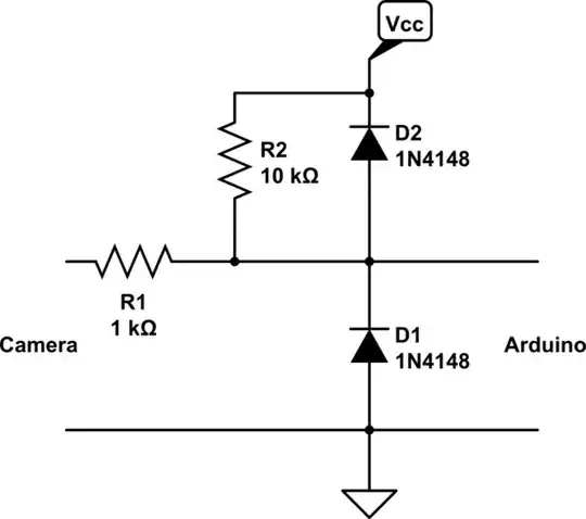

I built the exact circuit described in the answer, shown below, to detect when my canon DLSR hotshoe would send a "trigger" order to the flash. This trigger signal could then be dealt with by an Arduino.
Trigger detection circuit

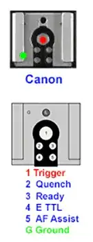

This is the hotshoe of the Canon camera below:
Canon Hotshoe
My Arduino detects when I fire the flash (pull trigger to GND,) but the weird thing is that it also detects when I half-press the shooting button, and sometimes keeps detecting if I keep the button half pressed for some time.
When I do shoot it always detects normally, so it works, but something is false triggering when I half press the button - and it's random.
If the camera is on and I don't press the shooting button, it works normally as it should, never detects any false "triggering".
What could I do to fix it? Is the Canon hotshoe trigger different from others?

  • Without some scope measurements on the sigal pin, it's a bunch of guessing. Taking a guess, I'd say you should add some input debouncing in your Arduino code. – Aaron Apr 01 '21 at 16:08
  • @Aaron I thought about debouncing. I’m actually doing it, but so far no difference. I’ll hook my mini scope to check the signal pin.. – Rodrigo Apr 01 '21 at 16:19
  • Please post the results, one for normal trigger and one for false trigger. – Aaron Apr 01 '21 at 16:20
  • Why would someone vote to close this as "not electronic design"? Thats abusing the close vote uuugggghhh. – Passerby Apr 01 '21 at 19:45
After seeing with the scope that the camera keeps sending fast pulses from time to time while the button is half-pressed, and a longer pulse when the button is fully pressed, I implemented the debounce function to only allow pulses that are longer than 5ms. That seemed to have solved the problem and the false triggerings!
