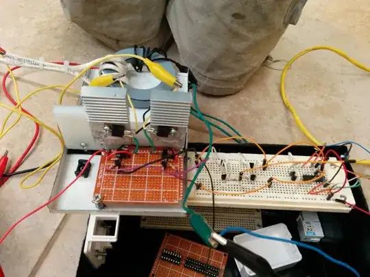

I modified my design to the circuit specified by 'jms'. I am using all 2N3906 and 2N3904 now. I found some other MOSFETs in my junk that I am using now. They are MTP50N05Es. These have an Rds of only 0.028 ohms. The drain current is up to 50 amperes. The Vgs is similar at no more than +/- 20 volts. I'm now using 10 ohm resistors to dive the gates from the emitter-follower circuit.

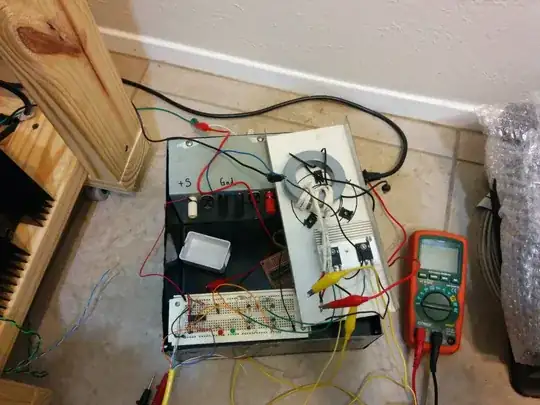

I built the driver circuit onto a perfboard on a small chassis I made. Without the MOSFETs hooked up I can measure a 9.85 khz signal on both the input and output of the circuit. With the MOSFETs connected I can measure only a 13.85 hz signal anywhere in the circuit.
I only have a 50 amp "12 volt" Astron power supply to drive this with. Actual output is closer to 14.5 volts. However, the smoothing capacitors in this power supply are huge. As a result, even with the circuit the voltage from the power supply drops very slowly. If I turn on the driver, connect the center tap and power on the Astron I see 13.85 hz on the output. If I then power off the Astron the voltage drops very slowly. After the voltage drops a bit, the whole thing just works. I can hear an audible ~10 khz tone, measure ~10 khz on the transformer secondary, and measure several volts of AC output on the secondary as well. Of course the capacitors eventually discharge and the circuit turns off. Why does this happen?
While I attempted to minimize the gate lead length I still wound up with about 3 cm of wire leading up from the perfboard to the gates. Is this enough to cause "ringing" of the gates? Please see the picture, the gate drives are green.
Update 2:
I've also tried moving the MOSFETs down onto the perf board (no heatsink). The gate drive connection is no just a 10 ohms resistor, nothing else. The behavior is identical to what I described above in update 1.

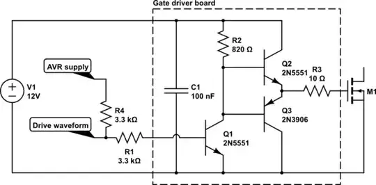

You can rectify this by adding a single NPN transistor as an inverting voltage amplifier:
schematic
This has the unfortunate side effect of inverting the drive waveform, the MOSFET gates will be high when the AVR outputs are low. R4 is there to prevent the MOSFETs from turning on when the AVR IO pins are in a high impedance state (e.g. when the ATtiny is starting up or glitches).

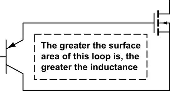

Stray inductance between the drivers and MOSFETs
You should try to minimize the area of the loop formed by the connection between the driver output and the gate and the current return path, or you will face ringing issues even with a well designed driver and a suitable gate resistor. Ideally the driver would be on the same PCB as the MOSFET, the conductors connecting the gate and drain to the driver transistors would be very short and the aforementioned conductors would be close to each other for the entire distance. In your update you did connect the gate with an acceptable length of wire, but the current return path is still very long, leading to just marginal improvement.
schematic
simulate this circuit
See this excellent answer for a more in-depth explanation.
