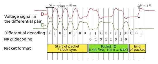

USB data is NRZ-coded such that "One" is represented by no change in physical level, and "Zero" is represented by a change in physical level (see figure below). Therefore, inverting the signal (for example, by swapping D+ and D-) results in no functional change during data transmission. But there may be problems before and after data transmission which can kill communication with the device.

While the data is NRZI-encoded, the synchronization sequence and EoP are defined in terms of fixed states (J/K/SE0). When D+ and D- are switched, the J state is switched with K and SE0 is still SE0 (both lines low). So the sync sequence and EoP will become incorrect on inversion. In USB 1.x, if D+ and D- are swapped, a full-bandwidth devices get recognized as low-bandwidth and vice-versa. So the device will not even communicate at the same speed as the host.

A USB packet's end, called EOP (end-of-packet), is indicated by the transmitter driving 2 bit times of SE0 (D+ and D− both below max) and 1 bit time of J state. After this, the transmitter ceases to drive the D+/D− lines and the aforementioned pull up resistors hold it in the J (idle) state.
With a D+/D- swapped driver, the host will see the sequence (SE0, SE0, K) instead of the correct (SE0, SE0, J). The host might then fail to recognize the end of packet, which would cause problems.
