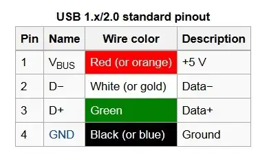

USB 1.x (1.5 Mbit/s and 12 Mbit/s) and 2.0 (480 Mbit/s) use four wires, V\$_{BUS}\$ (+5), D+, D- and GND. The D+ and D- form a differential pair. There is also an extension called OTG (On-The-Go) which allows a device to act as either a USB host or device, and this makes use of a fifth ID lead we can ignore.

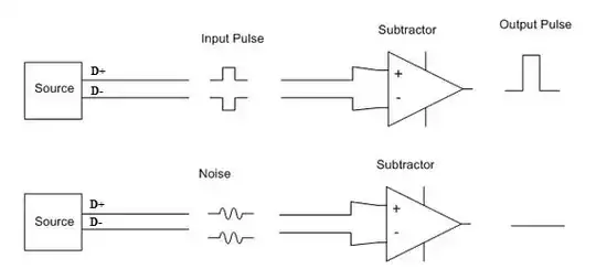

Differential signalling provides for a high degree of noise immunity. The data signals are sent going positive on the D+ line, and negative on the D- line. At the receiving side, the plus lead is sent into the + lead of a comparator (acting as a subtractor), and the minus lead is sent to the - lead of the comparator.
For valid pulses, these two add (since the negative going pulse was sent into the - lead of the comparator, they add). But if noise is induced on the line, it will in general affect both the D+ and D- lines the same, and the comparator will subtract them out.
The diagram shows data going in only one direction. That is because USB signals are half-duplex, the data only goes one direction at a time.
