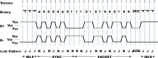

I couldn't find any reference that gave a definitive answer. But looking at a few datasheets, I don't think so. USB is looking at the presence or absence of a change in voltage. Whereas CANBus is looking at the voltage itself.
Here is an example of a USB transmission:
USB NRZ
The ones and zeros are coded depending on whether or not there is a transition.
