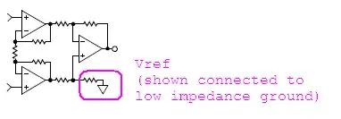

Notice the small block diagram in Fig.2 if the AD620 datasheet.
simplified block diagram a 3-OpAmp instrumentation amplifier from the AD620 datasheet

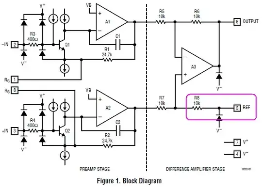

Here's a larger diagram from a datasheet of a similar InAmp with a 3-OpAmp topology (LT1920).
block diagram of a 3-OpAmp instrumentation amplifier from the LT1920 datasheet

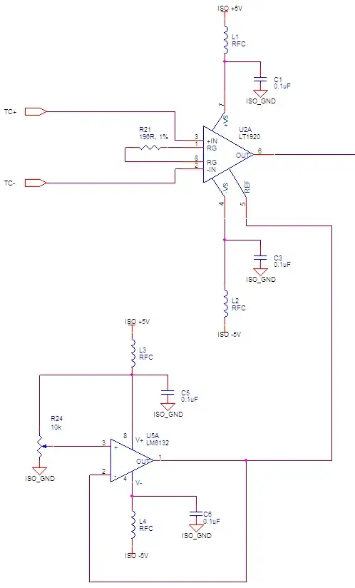

Notice that VREF is not a high impedance input. In order not to skew the differential output stage, VREF should be connected to a low impedance output. A voltage divider by itself is not a low impedance output. However, the voltage divider can be buffered.
I have built and tested a similar circuit. (In my case, the VREF came a source other than a potentiometer, though.)
