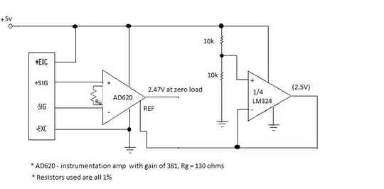

This is my preliminary circuit: enter image description here
What could be the problem? Any help would be appreciated. thanks!
In an ideal in amp the equation you have is true. In a real in amp we have to deal with something called offset voltage. This will be the real difference between the inverting and non-inverting inputs, as opposed to the 0 found in an ideal in amp.
Looking at the datasheet we see that it has a worst case value of 125uV. Multiplying this by the gain of 381 gives us about 48mV. Your output is therefore completely within spec.

Of course there's an offset voltage. Also, you're less than 2% off, so it can be because of resistor mismatch of your 10Ks, even for 1% resistors. In short, there's nothing wrong. If you need better, you need to trim it with a pot.
