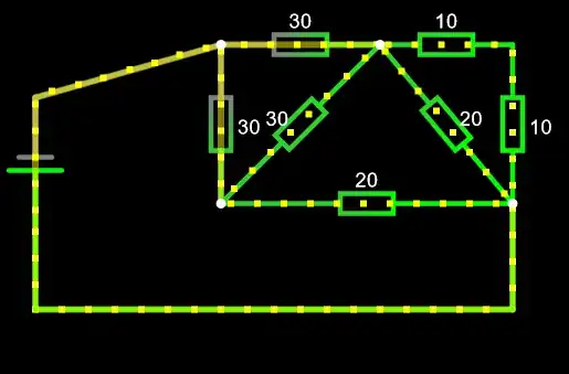

    @SpehroPefhany Certainly falstad figured out how to do it. – Niclas Nov 22 '23 at 19:43

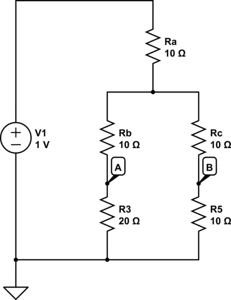

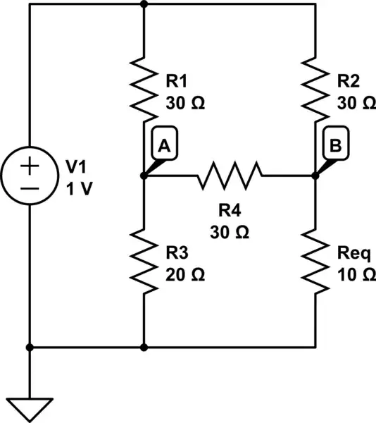

  • There is no common approach other than learning how to look at circuits and minimizing them using appropriate (but varied) techniques. – Andy aka Nov 22 '23 at 19:43

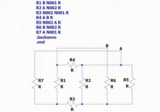

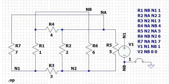

Here's a schematic in LTspice, including its netlist:
This netlist is in simple ASCII text. You can parse it, trivially. And I mean trivially! There are 7 lines you care about, obviously. Just write up a routine to read any resistor netlist saved by LTspice (or any Spice program, as all of them support these netlist Spice cards.) Make sure to label the two nodes that you care about making your measurement from. I've called them A and B but obviously you can make up anything you want, there.

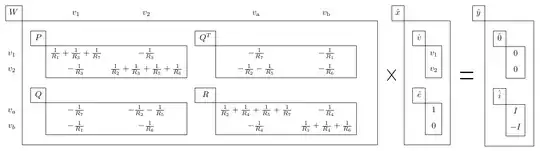

$$W=A^T\,C\,A=\left[\begin{matrix}P&Q^T\\Q&R\end{matrix}\right]$$ At this point, we've two choices. Either choice works just fine. One is that we set \$v_a=1\:\text{V}\$ and \$v_b=0\:\text{V}\$ and find out what currents we get. The other is that we set the KCL sum at \$v_a\$ to be \$1\:\text{A}\$ and at \$v_b\$ to be \$-1\:\text{A}\$ and find out what the resulting node voltages are for \$v_a\$ and \$v_b\$.
If we set the currents and solve for all the node voltages, the matrix solution is harder since you need to invert a larger matrix. So it's better (my view) to set the node voltages and find out what the resulting currents will be. This allows the use of the Schur complement.
So we will instead just set \$v_a=1\:\text{V}\$ and \$v_b=0\:\text{v}\$ and solve for the complementary currents (what enters must be the same as what leaves.) The value, \$R_{total}=\frac{1\:\text{V}}{I}\$, will be the resistance.
The full-blown setup follows (made with MiKTeX and Latex code I learned about here):
(Note that you would likely use numerical values for \$C\$ and so \$W\$ wouldn't look that complicated. It would just be some numbers there.)
We want to solve for \$\hat{i}\$. We don't care about \$\hat{v}\$, as it really doesn't matter to us. So we use the Schur complement to avoid having to solve for \$\hat{v}\$ (since we don't care about it.) By ignoring what we don't care about, the computation problem is made simpler.
The Schur complement is trivial to derive. Note that (1) \$P\hat{v}+Q^T\hat{e}=\hat{0}\$ and (2) \$Q\hat{v}+R\hat{e}=\hat{i}\$? From (1), solve as \$\hat{v}=-P^{-1}Q^T\hat{e}\$ and then substitute that into (2):
$$\begin{align*} \hat{i}&=Q\hat{v}+R\hat{e} \\\\ &=Q\left(-P^{-1}Q^T\hat{e}\right)+R\hat{e} \\\\ &=-QP^{-1}Q^T\hat{e}+R\hat{e} \\\\ &=R\hat{e}-QP^{-1}Q^T\hat{e} \\\\ &=\left(R-QP^{-1}Q^T\right)\hat{e} \end{align*}$$
And that's the Schur complement.
Do note that it reduces the size of the required matrix inversion, this way. Just a 2x2 rather than inverting an entire 4x4 (which would succeed at getting the right results, but is generally more work because it also solves for those two voltages, \$v_1\$ and \$v_2\$, which we really don't need to know.)
Also, you can easily invert a 2x2 by hand. Not so much with a 4x4, where it starts to get more painful.

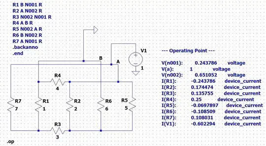

So, let's verify. Here's the initial schematic modified to include all the extra stuff needed to get a numerical solution:
Note that the current leaving the voltage supply has the magnitude of \$602.294\:\text{mA}\$ and that \$\frac{1\:\text{V}}{602.294\:\text{mA}}\approx 1.66\:\Omega\$.
And that is a match!!!
(And the current is also seen to have matched, too.)

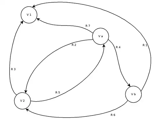

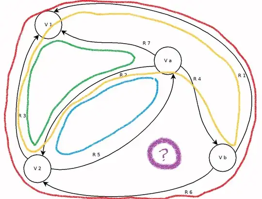

Looking at the circuit's directed graph (made with freely available Dia):
The first column vector above tells you that if you follow edge \$R_1\$ with its arrow, then go oppositely against \$R_3\$, then go oppositely against \$R_2\$, and then go with \$R_4\$, that you will have one mesh there. The second column vector says with \$R_2\$ and with \$R_5\$ is another mesh. (Parallel resistor pair.) The third column vector says against \$R_1\$, with \$R_6\$, with \$R_3\$ is another mesh. And the fourth column vector says against \$R_2\$, with \$R_7\$, against \$R_3\$ is another mesh.
These four meshes are colored in below:
Oh! Wait.
I added a 5th one, didn't I? The purple circle.
What about that mesh?
Well, it's just the sum of the yellow (1st), blue (2nd), and red (3rd) meshes. Let's double-check that:

A run of the above schematic shows:
I(V1):   -1.21739    device_current
Which is the expected result.

Personally I’d do it the good old “inspection route”:
  1. The upper right triangle reduces to 10Ω equivalent.
  2. The upper left triangle reduces to 30||60Ω=20Ω.
  3. Now we’re left with 10||(20+20)Ω=8Ω. That’s the load across the battery.
Hopefully I got that right :)
Should be all there’s to it. Complex networks may need a structured approach to analysis. The stuff you show is specifically designed for textbooks it looks like. If that’s a school assignment/book exercise, it was specifically put together to make mental math possible. Someone spent some time just so you can look at the problem and see the result in a minute or less, no calculator or anything.

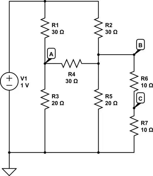

Algorithmically, you can repeat these steps until reduction is achieved:
  • Find series equivalents
  • Find parallel equivalents
  • Find deltas and convert to wye
  • Fine wyes and convert to deltas
Which of the last two are applied, depends, and you may have to go back and forth several times, or backtrack, to find the correct transformation.
Here, notice R6 and R7 are in series. Reduce them to a single 20Ω.
There is now a parallel combination, R5 || (R6 + R7). 20 and 20 makes 10Ω.
schematic
simulate this circuit
How we have the classic 'H' or bridge circuit. If the legs were equal (R1/R3 = R2/Req) we could ignore R4, but that is not the case here, so we need to reduce further. There are no series or parallel elements, so let's try a delta-wye transform.
schematic
We have the following substitutions: \begin{eqnarray} R_a &=& \frac{R_1 R_2}{R_1 + R_2 + R_4} \\ R_b &=& \frac{R_1 R_4}{R_1 + R_2 + R_4} \\ R_c &=& \frac{R_2 R_4}{R_1 + R_2 + R_4} \end{eqnarray}
Since the values are equal, the results are pleasingly simple. We could convert the other one instead (R3-R4-Req), getting 10, 5 and 10/3 Ω (showing these is left an an exercise for the student).
We have more series, and then parallel, equivalents. Rb + R3 = 30, Rc + Req = 20; 20 || 30 = 12. Final series, Ra + 12 = 22 Ω, and that's the answer.
