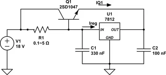

I made the same circuit as shown in the datasheet and used the 2SD1047 as Q1
https://www.st.com/resource/en/datasheet/2sd1047.pdf
schematic
But as I connected it to my bench power supply set to 18V I was not able to get a regulated output. It just showed ~2V less then the input voltage.
At 18V no load I got 16V output, 0.5A load 15V and 3A load 12V. I tried different values of R1 calculated by the formula shown in the data sheet.

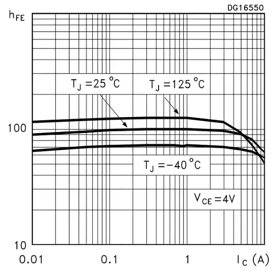

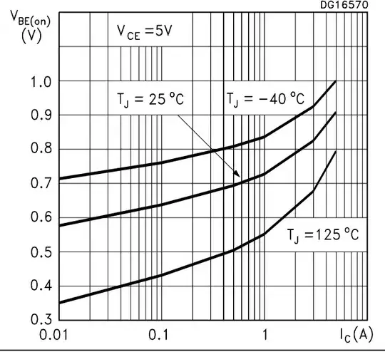

Is the output voltage affected by the the value of R1? Please Help. Beta of 2SD1047 Vbe While calculating R1 I assumed the value for Ireg to be 0.1A, Beta of transistor to be ~95, and IQ1 to be 3A, when that didn't work I tried a bunch of different values of resistors with the same results.

PS: SOLVED!! My mistake, I connected a NPN BJT instead of PNP.

    Glad you could work out some issues yourself. Yes, with a 'boost' transistor a minimum load is needed so the Vbe is high enough. Major mistake though. The boost transistor MUST be a pnp, with the 12 volt current boost coming from the collector. Try a MJE172. –  Mar 05 '19 at 05:02

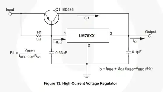

Here is the diagram from page 20 of the datasheet you linked:
Figure 13 from Fairchild LM78xx datasheet
Image source: Fairchild LM78xx datasheet, Figure 13
Notice that the pass transistor is PNP. The mistake in your design, is that you are trying to use a 2SD1047 NPN pass transistor - which won't work, as you have seen.
