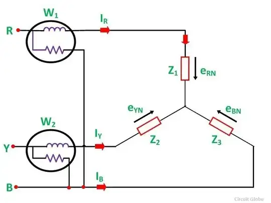

The simplest way to measure 3-phase power is the two wattmeter method: -
Image from here. Here are some other links to help you understand: -
