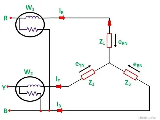

The simplest way is probably this; the two wattmeter method: -

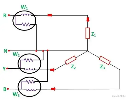

Image from Two Wattmeter Method of Power Measurement and, I mention this because, it is a true 3-phase measurement of power into a 3-phase load. There is also the three wattmeter method: -
Image from Measurement of Three Phase Power: Three Wattmeter Method and, again I'm showing old fashioned wattmeter methods because, if you want accuracy despite non-linear loads or asymmetrical voltage supplies you have to look at what a wattmeter does.
A wattmeter is an analogue multiplier of the voltage and current waveforms. In other words, it's \$v \times i\$ with no worries about power factor. If you try and calculate power using power factor then you have to measure phase angle between \$v\$ and \$i\$ and, the massive problem with this, is that a typical load may be somewhat non-linear (i.e. not wholly resistive) therefore, using zero-crossing detectors (for example) for estimating phase angle, is a bit useless and, gives rise to significant errors.
In other words, your formula assumes a balanced and linear load with a voltage source that is balanced both in amplitude and 120° phase angles. It's folly to think you might be able to do this for practical loads except a kettle and, I don't think they make three phase kettles. Sure there are 3-phase heating elements and these'll be OK but, in the main, you'll be disappointed with V.I.Cos(φ).
But, if your supply is both amplitude and phase balanced and feeds a linear load then you can use that method.
Going back to \$v \times i\$, you can employ modern digital techniques and sample at around 20 times the line frequency as a minimum to avoid current waveform harmonics contributing too much of an error. If you sample and multiply at a higher rate then even better.
Then you accumulate the \$v \times i\$ sampled value over (say for instance) 1 second and divide by the samples per second. Use this method in the equivalent of a two or three wattmeter method.

  • From what I understand so far typical apartment's load can not ever be balanced because you can plug anything into any wall socket. So even voltage may remain the same on all threee lines the currents differ completely. I guess my choice would be three-wattmeters. And I'll also try to add power factor measure to each of them – x_arrange Nov 25 '22 at 22:26
  • @x_arrange you don't need to add power factor measurements to compute power with the methods I've shown and described and linked. Power factor is a red herring for real practical power measurement. Nobody uses it because it just does not work unless you have perfect balanced sinewaves (amplitude and phase) and perfectly linear loads. Forget it as an option to help you with power measurement. – Andy aka Nov 25 '22 at 22:58
