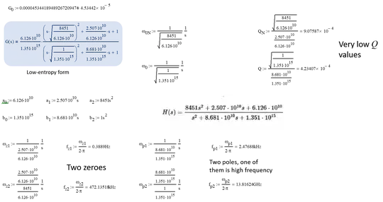

Breaking Down Your Transfer function
In your case, \$a_2=8.4505\times 10^3\$, \$a_1=25.0724\times 10^9\$, \$a_0=61.2553\times 10^9\$, \$b_2=1\$, \$b_1=86.807\times 10^9\$, and \$b_0=1.3513\times 10^{15}\$. Then it is just a matter of following the above recipe:
$$\begin{align*}
&\text{Numerator}  &&\text{Denominator}
\omega_{_0}^{\:'}&=\sqrt{\frac{a_0}{a_2}\vphantom{\frac{b_0}{b_2}}}\approx 2.692\times 10^3 & \omega_{_0}&=\sqrt{\frac{b_0}{b_2}}\approx 36.76\times 10^6
d^{\,'}=2\zeta^{\,'}&=\frac{a_1}{\sqrt{a_2 \,a_0\vphantom{b_2 \,b_0}}}\approx 1102.0 &d=2\zeta&=\frac{b_1}{\sqrt{b_2 \,b_0}}\approx 2361.5
\end{align*}$$

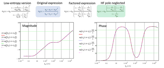

Before pursuing this as Verbal Kint did (I'll get to that in a later section), I'd like to follow through with a different process that leads to an interesting, separate result:
$$\begin{align*}
G_s&=\frac{a_0}{b_0}\cdot\left[\frac{\left(\frac{s}{\omega_{_0}^{\:'}}\right)^2+d^{\,'}\left(\frac{s}{\omega_{_0}^{\:'}}\right)+1}{\left(\frac{s}{\omega_{_0}}\right)^2+d\left(\frac{s}{\omega_{_0}}\right)+1}\right]
&=\frac{a_0}{b_0}\cdot\left[\frac{\left(\frac{s}{\omega_{_0}^{\:'}}\right)^2}{\left(\frac{s}{\omega_{_0}}\right)^2+d\left(\frac{s}{\omega_{_0}}\right)+1}+\frac{d^{\,'}\left(\frac{s}{\omega_{_0}^{\:'}}\right)}{\left(\frac{s}{\omega_{_0}}\right)^2+d\left(\frac{s}{\omega_{_0}}\right)+1}+\frac{1}{\left(\frac{s}{\omega_{_0}}\right)^2+d\left(\frac{s}{\omega_{_0}}\right)+1}\right]
&=\frac{a_0}{b_0}\cdot\left[\frac{\left(\frac{\omega_{_0}}{\omega_{_0}^{\:'}}\right)^2\left(\frac{s}{\omega_{_0}}\right)^2}{\left(\frac{s}{\omega_{_0}}\right)^2+d\left(\frac{s}{\omega_{_0}}\right)+1}+\frac{\left(\frac{\omega_{_0}}{\omega_{_0}^{\:'}}\right)\left(\frac{d^{\,'}}{d}\right)d\left(\frac{s}{\omega_{_0}}\right)}{\left(\frac{s}{\omega_{_0}}\right)^2+d\left(\frac{s}{\omega_{_0}}\right)+1}+\frac{1}{\left(\frac{s}{\omega_{_0}}\right)^2+d\left(\frac{s}{\omega_{_0}}\right)+1}\right]
&=\frac{a_2}{b_2}\frac{\left(\frac{s}{\omega_{_0}}\right)^2}{\left(\frac{s}{\omega_{_0}}\right)^2+d\left(\frac{s}{\omega_{_0}}\right)+1}+\frac{a_1}{b_1}\frac{d\left(\frac{s}{\omega_{_0}}\right)}{\left(\frac{s}{\omega_{_0}}\right)^2+d\left(\frac{s}{\omega_{_0}}\right)+1}+\frac{a_0}{b_0}\frac{1}{\left(\frac{s}{\omega_{_0}}\right)^2+d\left(\frac{s}{\omega_{_0}}\right)+1}
\end{align*}$$
The last result above is what's important. It converts what appears to be an abstract and somewhat impenetrable pair of 2nd order polynomials into the key ideas required to understand their combined behaviors. (The first term is a high-pass, the middle term is a band-pass, and the final term is a low-pass and the gains for each are separated out, now.)
Note that it also now becomes more obvious why \$a_i\$ can be zero while \$b_i\$ cannot be.
As you can see, the whole thing breaks into a nicely expressed standard form.
And this is where I got the gain factors for my earlier comment: \$\frac{a_2}{b_2}\approx 8.5405\:\text{k}\$, \$\frac{a_1}{b_1}\approx 288.83\:\text{m}\$ and \$\frac{a_0}{b_0}\approx 45.331\:\mu\$ (this last one is Verbal Kint's \$G_0\$.)
You can feel free to replace \$d\$ with either \$2\zeta\$ or \$\frac1{Q}\$. Doing that and multiplying everything by \$\frac{\omega_{_0}^{\:2}}{\omega_{_0}^{\:2}}\$ yields:
$$\begin{align*}
G_s&=\frac{a_2}{b_2}\cdot\frac{s^2}{s^2+2\zeta\,\omega_{_0}s+\omega_{_0}^{\:2}}+\frac{a_1}{b_1}\cdot\frac{2\zeta\,\omega_{_0}s}{s^2+2\zeta\,\omega_{_0}s+\omega_{_0}^{\:2}}+\frac{a_0}{b_0}\cdot\frac{\omega_{_0}^{\:2}}{s^2+2\zeta\,\omega_{_0}s+\omega_{_0}^{\:2}}
\end{align*}$$
Which is the other standardized form and the one I indicated in comments, earlier.

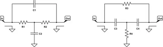

A Short Note
More commonly, a transfer function only includes one of the above three terms and is either entirely a low-pass, entirely a high-pass, or entirely a band-pass transfer function.
But either of these simpler passive networks will result in a transfer function that includes all three terms:
Other arrangements with different elements can be readily produced. But the above are, in my mind anyway, two of the simplest ones using ideal components that can get you there.

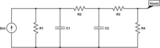

Again, you can have a gain with units, such as Ohms. For example, suppose the following case:
simulate this circuit
The transfer function is:
$$\begin{align*}
G_s&=A\cdot\left[\frac{1}{\left(1+\frac{s}{\omega_{_\text{L}}}\right)\left(1+\frac{s}{\omega_{_\text{H}}}\right)}\right]
\end{align*}$$
In this case, \$A=\frac{R_1\,R_4}{R_1 + R_2 + R_3 + R_4}\$ and the units are definitely \$\Omega\$.
