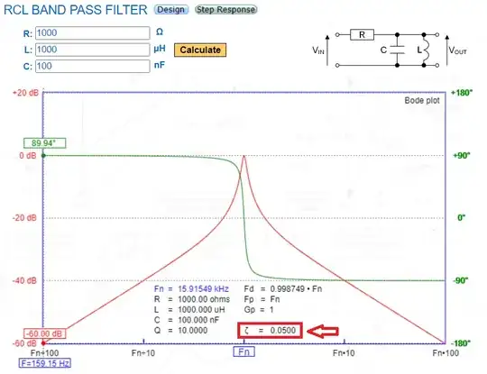

Hence, \$\hspace{0.5cm}\zeta\hspace{0.5cm} =\hspace{0.5cm} \frac{1}{2R}\sqrt{\frac{L}{C}}\hspace{0.5cm}\leftarrow \hspace{0.2cm}\$ (corrected as per comments)
Or just use the calculator from my basic website: -

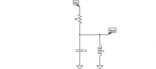

Get rid of the input supply and don't bus wires:
schematic
Without over-thinking things too much yet, the above may be a little easier to notice as a simple voltage divider: \$V_{_\text{OUT}}\$ is just a divided-down part of \$V_{_\text{IN}}\$. So \$V_{_\text{OUT}}=V_{_\text{IN}}\cdot\frac{Z_{_\text{C}}\mid\mid Z_{_\text{L}}}{R+\left(Z_{_\text{C}}\mid\mid Z_{_\text{L}}\right)}\$.
Or put another way, \$\frac{V_{_\text{OUT}}}{V_{_\text{IN}}}=\frac{Z_{_\text{C}}\mid\mid Z_{_\text{L}}}{R+\left(Z_{_\text{C}}\mid\mid Z_{_\text{L}}\right)}\$. That right side is the so-called transfer function.
Plugging in \$Z_{_\text{C}}=\frac1{s\,C}\$ and \$Z_{_\text{L}}=s\cdot L\$ you might get this: \$\frac{V_{_\text{OUT}}}{V_{_\text{IN}}}=\frac{L\,s}{R\,C\,L\,s^2+L\,s+R}\$. You don't need the numerator to work out the damping factor. All you need are the coefficients in the denominator, \$a_2\,s^2+a_1\,s+a_0\$, as \$\zeta=\frac12\frac{a_1}{\sqrt{a_2\cdot a_0}}=\frac12\frac{L}{\sqrt{\left(L\,C\,R\right)\cdot R}}=\frac1{2\,R}\sqrt{\frac{L}{C}}\$.

$$\begin{align*} \frac{V_{_\text{OUT}}}{V_{_\text{IN}}}&=\frac{Z_{_\text{C}}\mid\mid Z_{_\text{L}}}{R+\left(Z_{_\text{C}}\mid\mid Z_{_\text{L}}\right)}= \frac{\frac1{s\,C}\mid\mid s\,L}{R+\left(\frac1{s\,C}\mid\mid s\,L\right)}= \frac{\frac{\frac1{s\,C}\,\cdot \,s\,L}{\frac1{s\,C}+ s\,L}}{R+\frac{\frac1{s\,C}\,\cdot \,s\,L}{\frac1{s\,C}+ s\,L}} \\\\ &\cdot\frac{\frac{s\,C}{s\,C}}{\frac{s\,C}{s\,C}}=\frac{\frac{L\,s}{L\,C\,s^2+1}}{R+\frac{s\,L}{L\,C\,s^2+1}} \\\\ &\cdot \frac{L\,C\,s^2+1}{L\,C\,s^2+1}=\frac{L\,s}{R\,C\,L\,s^2+L\,s+R} \end{align*}$$
