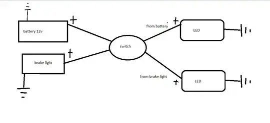

Hi I'm new to electronics and have little idea how electricity works. I have a motorcycle and wanted to add two LED lights. I want to have one switch in both LED but with different sources.
The first LED (which will be placed in front of the motorcycle) is from the battery, so when I turn on the switch the first LED will turn on. The second LED (which will be placed at the back of the motorcycle) is from the brake light, so whenever I press the brake and the switch is on the second LED will turn on but if I press the brake and the switch is off the second LED will not turn on. Is this possible?
diagram

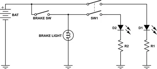

Here's a schematic diagram which includes a double-pole single-throw (DPST) switch that should, as @Eugene commented, do what you need:
schematic
When the switch is off, both LEDs will be off. When the switch is on, D1 will be on. D2 will also be on, but only if the brake is on.
I included the brake switch (BRAKE SW) only so you can see that D2 will only light when both the brake is applied as well as SW1.
I've added R1 and R2 which are current-limiting resistors so that the LEDs don't burn up. You can find lots of questions and answers on the site about how to select these:

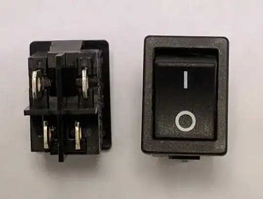

If you're unfamiliar with switch wiring, check out Paul Nicholl's guide. For example, here's a DPST switch image from that source:
DPST switch
Vertically, each "column" of contacts is a pole. When the switch is off, the top and bottom contacts are not connected (said to be "open"). When the switch is on, they are connected (said to be "closed"). The left and right sides are separate and never connected to each other.
The dotted line in the schematic indicates that the two poles operate together, due to the physical actuation of the switch.
