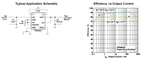

Powering an LED with a battery and using a current limiting resistor is not recommended. Especially for a lantern where you want a more consistent luminous output.
You could use a buck/boost DC-DC converter to keep the voltage consistent and adjust the output voltage for a high efficiency current liming resistor.
You must first measure the actual Vf then adjust the output voltage
The TI High Efficiency Single Inductor Buck-Boost Converter TPS63030DSKR was made especially for this type of application (i.e. battery powered white LED).
