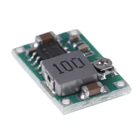

To fix the overheating problem, I bought this 3A 5V-23V to 3.3V 6V 9V 12V 340KHz Mini DC-DC Step-down Converter Voltage Regulator Power Supply Module:

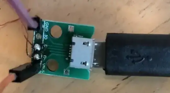

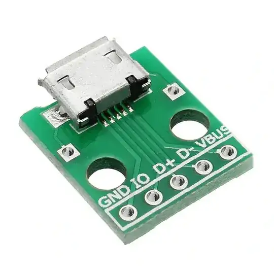

I also wanted to try to replace the hardwired USB cable with a female micro-USB connector (so that I could use different length cables depending on what I use it for), so I also bought this Micro USB To Dip Female Socket B Type Microphone 5P Patch to Dip 2.54mm Pin with Soldering Adapter Board:

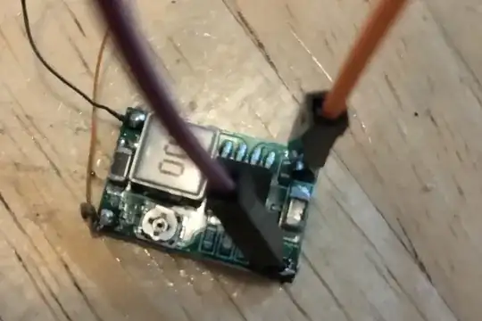

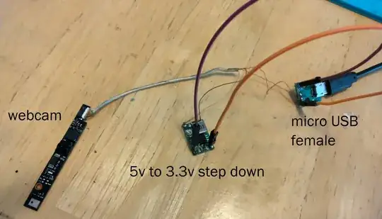

I used a voltmeter and a screwdriver to set the step-down board to about 3.39V and when I resoldered the camera to these pcbs (using a USB to micro-USB charging cable to connect to the female micro-USB pcb connector to my computer), my computer no longer recognized the camera USB connection at all. What am I doing wrong?

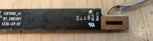

According to the webcam board, black is 3.3V, orange is ground, brown is D- and red is D+.
I connected the webcam's brown to the female micro–USB D- and the red to the D+ as shown.
My own orange wire (separate from the webcam's orange wire) coming from VBUS and the purple wire on GND then go to the step-down board as +IN and -IN respectively.
The +OUT and -OUT (which I have measured and should be at about 3.3V) then go into the webcam's black and orange wires respectively.
To test what was not working, I tried to bypass the female micro-USB connector pcb, but keep the step-down pcb in by using the original hardwired USB cable I had used, and the camera was recognized and seemed to be running on 3.3V instead of 5V.
I'm assuming from this that my problem comes from a misunderstanding of either micro-USB female connectors in general (like what to do with the ID (looks like an IO on the board I bought) pin (I have tried leaving it unconnected and also connecting it to ground which i figured from here)) or a misunderstanding of the specific female micro-USB connector board I bought.
