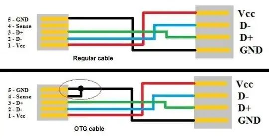

This is not possible for micro B or type C. Lightning is not as well documented but likely similar. USB-C to C cables will enable this sort of thing by design and include a dedicated CC wire in the cable partly for this reason but existing USB-A terminated cables cannot do what you want and electrically identify themselves as connecting to an upstream port.
For USB micro B The connector has a fifth pin (sense) that electrically identifies what role the connected device should assume. Normal cables leave this floating and various resistances to ground mean different things (shorted==USB upstream,100K=USB upstream w/ external 5V). Obviously this isn't accessible at the USB A end of the cable.
USB C does something similar with the CC pins which are again handled by the USB-C connector on the end of the cable for A to C cables. These identify themselves electrically as connecting to an upstream device and this cannot be overridden at the USB A end.

  • Thank you, but if understand you correctly, if I resolder USB-c female there instead - it will work on USB-c2usb-c cable with USB-c devices.
    I have a few usb-c female ports handy, will try it tomorrow.
    – Gino Feb 15 '21 at 05:56
  • you'll need a 5.1K resistor between each CC pin on the female USB-C port and ground. https://electronics.stackexchange.com/questions/442063/usb-c-ufp-cc-configuration-what-rd-resistor-value-i-need-to-use-to-be-able-to-d – Richard Thiessen Feb 15 '21 at 23:11

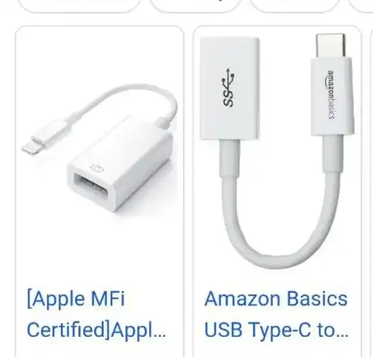

  • This is how the story ends :) after re-soldering, the contacts on the card one of the contacts on the card itself fell off and now I need to buy a new one :)
    Now, huge thanks for brining new word "OTG" to my vocabulary. I found the way of solving my problem with existing adapters. Yes, I have to use 2 of them but this way it does work and I get the usb-c female out

The point is that putting a female USB-C receptacle on the audio adapter will be insufficient to get it to work with a smart phone cable with a male USB-C plug on the end. It would still be a legacy USB device and would need something to tell the smart phone it is plugged into a legacy USB device. The thing that tells the smart phone it is connected to a legacy USB device are the USB-A female receptacle adapters. Then it would take a cable with a male USB-A plug and a male USB-C plug to connect it.
