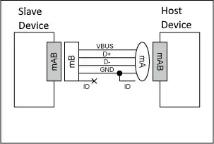

It's for On-The-Go, to select which device is the host or slave:
The OTG cable has a micro-A plug on one side, and a micro-B plug on the other (it cannot have two plugs of the same type). OTG adds a fifth pin to the standard USB connector, called the ID-pin; the micro-A plug has the ID pin grounded, while the ID in the micro-B plug is floating. The device that has a micro-A plugged in becomes an OTG A-device, and the one that has micro-B plugged becomes a B-device. The type of the plug inserted is detected by the state of the pin ID .
OTG ID

    And since a Type-A connector is nearly always host it doesn't need to have a 5th pin? – Sponge Bob Jul 10 '12 at 22:42
    If you mean a standard 4-pin Type-A plug, this would be used for a permanent host - you wouldn't use this in an OTG device. The ID pin is only used if the device can change between host and slave. For standard USB the ID pin is just left disconnected in the device. – Oli Glaser Jul 10 '12 at 23:28
    @SpongeBob Also, OTG didn't exist when the Type-A connector was created. – endolith Aug 01 '16 at 18:54
    It might be helpful to "restate the obvious": before the cable is attached, both devices in the illustrated scenario are eligible to be a host or slave device. It is when the cable is connected that the device attached to the A-end of the cable becomes the host, and the device attached to the B-end of the cable becomes the slave. In situations where a device is always intended to be a host device, the mini-A and micro-A connectors exist that will only accept the A-end of the OTG cable. In such situations, the device is explicitly a host device. – Toybuilder Oct 07 '18 at 05:16
    Also should be mentioned that Micro-A connectors essentially don't exist. Manufacturers ignored the spec and used Micro-B for both ends. https://electronics.stackexchange.com/a/242575/142 – endolith Aug 13 '20 at 13:15
  • The device should have a micro-AB connector so it can accept either the micro-A or micro-B plug -- so the user can orient the cable as desired. – Simon Richter Nov 24 '20 at 18:41
    @SimonRichter Technically, yes, but nobody uses micro-AB connectors in reality. This would actually be a micro-B to micro-B cable, with the ID pins determining the Host and Device. – endolith Mar 18 '21 at 20:18

To complete Oli Glaser's answer, 5 pins USB respects the On-The-Go standard (OTG). The additional pin added to the conventional USB port is the ID pin added to the 4th electrical pin, and allow to recognize the device. Here is the resulting electrical setup of the pins:
  1. VDD (+5V)
  2. D- (Data-)
  3. D+ (Data+)
  4. ID (ID)
  5. GND (Ground)
As compared to other 4-pins USB devices, where there is no ID pin, the advantage is to be able to distinguish the host device from slave devices.
  • Host: ID connected to GND
  • Slave: ID not connected (floating)
Host-Slave Schematics
There is no info carried by the 4th pin. When connected to the ground (5th pin) it serves to notify the host that it is connected to a dumb-client device instead of a smart-client device. This is confusing at best because some client devices only act as dumb-clients and some client devices can be either smart-client, another peer-host, or a pass-through repeater. You will probably only ever see OTG actually used in case of a keyboard being plugged into the micro or mini connector on a tablet computer. Other client devices usually have enough inherent software capability to notify the host that they are a client using the normal 4-wire USB connection.
frnhr
  • 103
Arv
  • 69
    There is information carried here, just not "data" -- the information comes in the form of whether or not the ID pin is shorted to ground. This can be used by devices which can serve either as clients or (OTG) hosts. It may not be used for transmitting data from one side of the cable to the other, but it does provide information. Pedantic, perhaps, but in situations like this, it seems to me that such distinctions matter. – lindes Jan 29 '21 at 19:48

None of the answers are quite correct/complete.
From Microchip FAQ on the subject:
Below is a general guide for connecting the USBID pin from a microcontroller:
USB HOST role
    The USBID pin (microcontroller): unconnected
    ID pin (USB connector): connected to ground
USB OTG role
    The USBID pin from microcontroller: connected to ID pin (USB connector)
USB DEVICE role
    USBID pin (microcontroller): connected to ID pin (USB connector)
    or
    USBID pin (microcontroller): unconnected and ID pin (USB connector): unconnected
So you should NOT leave the ID-pin floating if you've got OTG functionality in mind for your tablet or whatever. In that case connect it to the ID pin on the Micro-B (*) connector. The OTG cable grounds the ID pin unlike a regular USB cable so your tablet knows to expect that USB stick on the other end of the cable which requires power etc.
Basically if the ID signal going to processor signal is grounded, that device wants to supply power to the USB and initially behaves as the host. The roles can then be reversed by negotiation over the USB but that's off your hands as the hardware designer unless you dapple in firmware as well.
Presumably the ID pin should have a pull-up either internally or externally on the OTG device but the datasheets are vague on the subject.
(*) According to the standard it should be really be a Micro-AB connector which can take both A and B plugs and A-connector should indicate OTG usage. In reality you're probably dealing with a Micro-B plug to USB-A socket cable.
