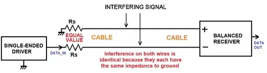

Interference is generally a phenomena that occurs between the thing that transmits the signal and, the thing that receives the signal. This usually means that buffering the sending-end can be ineffective. It also means that buffering the receiving end can also be ineffective. The best first thing to do is "balance" your signal.

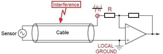

Unbalanced signals are prone to interference: -
The most effective method of reducing interference is using a balanced transmission method i.e. use two wires twisted together being fed from similar impedances at the sending-end then, using a differential receiving circuit at the receiver. Adding a shield to the twisted-pair cable adds another level of interference prevention.

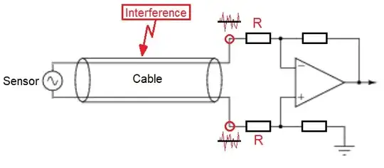

Balanced signals are less prone to interference: -
Single-ended signals can be made to be balanced: -
Of course, if the signal you wish to transmit is very small in amplitude, it helps to amplify it before sending it but, not using a balanced transmission system is usually the main reason for poor performance.

Thanks for this explanation. Since the buffering lower the source impedance, it should help to balance the pair or am I wrong? – Tanguy Oct 23 '21 at 11:03
@Tanguy not really. Using resistors is the best way to provide a balanced impedance. See the last diagram in my picture where the two resistors are labelled "equal value". You then still have to provide a balanced impedance at the receiver too AND use a proper differential amplifier to cope with common mode noise interference. – Andy aka Oct 23 '21 at 11:17
