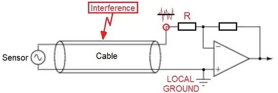

Yes there will. Consider this example circuit: -
The "sensor" might as well be a current transformer output and, if you have some length of balanced cable between it and your single-ended measurement circuit, then noise or interference won't be seen equally on both inputs of your single-ended amplifier. This is because the input impedances of the single-ended amplifier won't be equal. The "balanced" solution is to do this: -

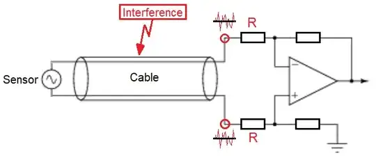

Because both inputs into the differential receiving amplifier have the same impedance to local ground, the interference waveform is seen equally at both input nodes and, the effect of the differential amplifier is to cancel those signals out. This is a balanced input impedance.
