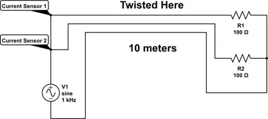

Would twisting 3 wires together like a twisted pair would be as effective as an ordinary twisted pair? Or at least a definite improvement to not twisting them at all?
schematic
I need to measure the current of each load and I can only do it near the voltage source. Although I plan to use an ethernet UTP cable of which I can just use another wire for a second ground. I am curious if a 3 wire twisted cable is as effective as the twisted pair or it might be not as effective but close.
Intuitively speaking it should still work because the EMI would still cancel out assuming the wires are twisted properly.

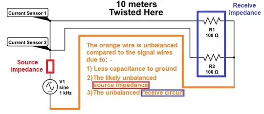

The effectiveness of a good twisted pair cable relies on these things to largely eradicate differential-mode induction: -
  • What source feeds it and
  • What receive circuit it connects to
So, if the send and return wires (and their associated transmit and receive circuits) don't present a balanced impedance to ground, then twisting is not effective at countering magnetic interference.
  1. The return wire will have less capacitance to ground hence it won't be balanced
  2. The receive circuit input impedance is not balanced
  3. The transmit circuit may not be very well balanced
  4. Twisting by itself isn't a solution to electric field interference
You are probably wasting time twisting them under these circumstances.
