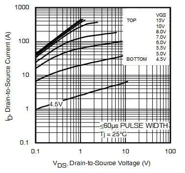

Edit: Based on @Andy aka's answer, I'm now considering IRFB7440PbF. It has a low Rds(on), a suitable Vgs in my case (max 3.9V), and the voltage drop should be appropriate, as if I read properly, at 5V it whould be 0.2V
Voltage drop chart
Edit 2: No, this was a terrible idea, IRFB7440PbF is a N-MOSFET, not a P one!

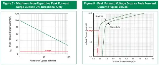

Those TVSs are bidirectional devices so, I suggest you consider unidirectional types because they will naturally restrict the reverse voltage to something less than 1 volt. I would also suggest you consider using a 6.3 amp fuse so that if someone did wire the supply the wrong way round then, the fuse would protect the TVS and, in turn, the TVS would protect the main part of your circuit.

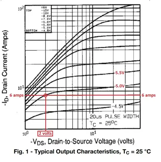

would something IRFP9140 be a better choice?
The simple answer is when running from a 5 volt supply the volt drop of the MOSFET would be terrible (2 volts) at 6 amps. So, when you are advised this: -
You need to choose a MOSFET with maximum Vth less than your supply (e.g. 5V) to make sure it will turn on when power is applied.
You need to be very careful about believing it. The IRFP9140 has a threshold voltage that is no more than 4 volts but, as per the graph above, it clearly is a poor choice when the current is anything more than a few hundred mA. Always look in the data sheet for the graph above.

  • Glass fuses should be fine but, it's mainly down to your choice. A unidirectional device will take out negative spikes because it acts like a normal forward biased diode - see figure 8 in my answer. And, it also gives reverse protection to less than 1 volt. – Andy aka Aug 31 '21 at 07:47
