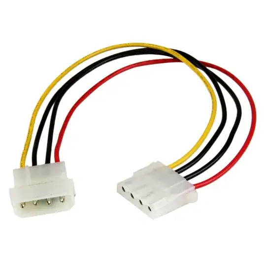

I suggest you use polarized connectors rated for 10A.
If you only need 1 , these are pretty common and can be paired and cut in half with soldered pigtails at one end and screwed into terminal block on supply. Plan on using tiny tie wraps to tie holes to prevent stranded wire strain and breakage.

  • I'm at designing a pcb that includes a esp8266, microphone, and dellas temperature sensor and pir. The power goes into the pcb and not direct into the LEDs. Reverse polarity would may damage the capacitors and other components. I only want to be sure that nothing bad with reverse polarity can happen. – Marlon Otto Dec 21 '19 at 23:52
  • Normally you choose polarized plug and PCB receptacle to avoid this , like a 4 pin 10A Molex connector once used for HDD's – Tony Stewart EE75 Dec 21 '19 at 23:54
