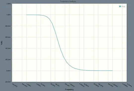

If you send various frequencies through it, you get this plot:
That plot is the reason we say that inductors block AC.

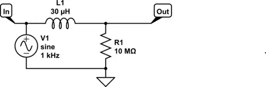

A typical multimeter can only measure AC voltage to (maybe) 1000 hertz. At 1000 hertz, the reactance is still far less than 1 ohm. Since a typical multimeter has an input impedance of 10 million ohms, it would be like measuring the response of an RL low pass filter made like this:
schematic
simulate this circuit

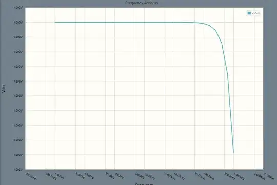

As you can see, nothing interesting happens to the signal until you get above 50kHz - that is far outside of what you can measure with a normal multimeter:
To show the response of small inductors, you need an oscilloscope and a signal generator that can both cover a range from (near) DC to several MHz. Inductors large enough to make a difference that you can measure with a multimeter at audio frequencies must be very large. That 1 henry inductor that I used as an example above would make a difference that you could measure at audio frequencies using a multimeter.

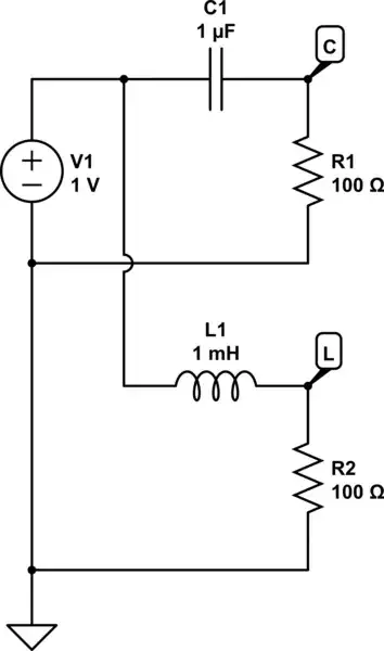

If we consider a circuit where L and C substitute:
schematic
(give the AC simulation a try), we have zero gain at C at 0Hz, and zero gain at L at ∞Hz.
In the real world, we cannot achieve exactly zero or infinite frequency, and it should be understood that "blocks" is a relative term: when the amount is much less than the nominal (pass-band) level, hopefully with some defined threshold (half, 1/10th, 1/1000th, etc.). The threshold is arbitrary, but it suffices that it works the same with respect to any given fraction.
Note that low voltage across the resistance, means low current through it. Thus DC current or AC current has been blocked, in the respective case.

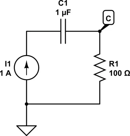

It does not mean that a series element can block an ideal current, like so:
schematic
Here, a current is defined into a single loop, so the answer can never be anything other than the given current, and C will always be 100V. Technically, there is a divide-by-zero at 0Hz, where voltage diverges (infinite), but the limit in magnitude voltage is equal above and below 0Hz, so it is a removable discontinuity.
That is, voltage is of the form \$x/x\$, and we have a limit of \$0/0\$ which is undefined. This is true whether L or C is used, exchanging the limit for ±∞ of course -- for which we get a limit of \$\infty / \infty\$, again undefined, but again a removable discontinuity.
