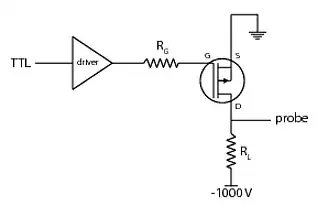

Would a p-channel depletion mode MOSFET make the most sense if the goal is to produce a high-voltage negative square pulse?
My reasoning:
  1. MOSFET, because we're talking about a kV square pulse with fast transition times,
  2. p-channel, because that puts the source at/near ground, so the gate can be ground referenced (and not floating on -1000 V, as would be the case in an n-channel circuit),
  3. depletion mode, because the load resistor must always be on the drain side, which would be -1000 V, so we'd like the MOSFET to be "on" most of the time to keep the output at 0 V, and then turn "off" briefly to take us to -1000 V and back.
The problem is that "p-channel depletion mode" MOSFETs seem to be scarce, which leads me to assume either I'm doing something wrong, or my application is unusual. Is my analysis of these types of MOSFETs incorrect, or are there really just not many manufacturers? Or is there a much better way of doing this that I'm missing?
(More details...) I need to produce a negative pulse with the following specifications:
  • amplitude: -1000 V (ref to gnd)
  • width: 100 microseconds
  • period: 20 Hz
  • risetime (leading edge, 10% to 90%): 1-2 microseconds or less
I'm just switching the potential difference (ref to gnd) on a chunk of stainless steel metal between 0 V and -1000 V quickly. I'm not driving a motor, or some huge inductive/capacitive load.
The circuit I'm thinking of is this:
higgy
  • 63

  • @vicatcu - switching the electric field near a group of atoms for a spectroscopy experiment. – higgy Feb 12 '13 at 15:22

  • Then you want the transistor pulling to -1000V, not the resistor. –  Feb 12 '13 at 16:48
    You might want to consider an IGBT like an IRG4PH20K from international rectifier. It will hit the voltage and switching speed requirements. – placeholder Feb 12 '13 at 21:29
The first problem with this approach is that having the transistor ON most of the time is VERY inefficient; you are dropping 1000V across Rl most of the time. Much better to turn the transistor ON for very short pulses. It'll shrink your 1000V supply needs for a start. (This means interchanging R and FET)
You could use an N type to pull down, with some isolation (opto, or pulse transformer) to its gate drive.
If R-C is too long to meet your rise time spec, you can use a totem pole (another FET in place ofthe resistor)

  • I agree it would be inefficient. The problem I see with any N-channel MOSFET is that I'd have to float the trigger pulse (to the gate) on the source (which for N type would be at -1kV, in this scenario). I assume that'd involve either a gate driver that is capable of floating on a -1kV, or a transformer or capacitor, which would ruin the flat pulse top for long pulse durations. – higgy Feb 12 '13 at 15:34
  • Agreed - as I said you would need some isolation. Optoisolation may be feasible without the drawbacks of a transformer. There are isolated gate drive solutions; I just think finding the right one is probably better than wasting 1000V power. If it turns out you need totem pole drive, you need to solve that problem anyway. –  Feb 12 '13 at 15:41
  • @higgy driving a high-side N-channel MOSFET isn't that hard. I have an H-bridge with a fairly detailed description which does exactly that. Or, as Brian says, an opto could work. What you are looking at building is essentially a higher voltage version of what I have there. – Phil Frost Feb 12 '13 at 16:22

I'm going to stretch my expertise a bit here and say, no, that is not the right approach. For a number of reasons:
  • I can't find any distributor selling such a device. N-channel is more common than P-channel, enhancement mode is more common than depletion mode, and 1kV is a higher voltage than most MOSFETs can handle. I see no reason such a device couldn't be fabricated, I'm just not sure anyone has bothered to do it.
  • If you need a fast transition from the high to the low voltage, the low-impedance path (the transistor) needs to be on the low side, not the high side.
This will be easier to implement if instead of thinking of it in terms of ground and -1kV, you think of it as ground and +1kV. If you want to stick the +1kV into a grounding rod so you get -1kV with respect to Earth, then by all means go ahead. As long as your power supply is galvanically isolated and the insulation in the transformer doesn't fail at those voltages, it won't make a bit of difference to the operation of the circuit. After all, the electricity can't see the labels on the schematic, so why should you care?
\$R_L\$ will have to be fairly large to avoid being vaporized by the high power resulting from the high voltage. \$ P = E^2/R \$, so if we want to do this with a \$\frac{1}{2}W\$ resistor:
\$ 0.5W = \dfrac{(1kV)^2}{R_L} \$
\$ R_L = \dfrac{1MV}{0.5W} = 2M\Omega\$ (absolute minimum)
This will put a bound on how fast the voltage can rise, since all the parasitic capacitances of the plate, transistor, etc, will resist a change in voltage. \$100 pF\$ is a reasonable guess, giving a time constant of
\$ \tau = 2M\Omega \cdot 100pF = 200\mu s\$
The 10% to 90% time will be somewhat longer, but our 100pF was just a guess anyway, so more complicated math isn't really justified. However, this does demonstrate why you need the transistor on the low side if you need that transition to be the fast one.
From there, it's just a matter of finding the right transistor. Mouser.com has some MOSFETs that could fit the bill. Some are a bit pricey, but would work. You will need a good gate driver to meet your transition time requirements. Power MOSFET Basics - International Rectifier is a good read.
You might also investigate IGBTs. I don't have much practical experience with them, but they are favored in higher voltage applications such as this. I think you can find a MOSFET that will work, but the IGBT might get you better performance at a lower cost.

  • It is essential the the pulse have a "flat" top for at least 100 microseconds, which makes me think I should rule out the inductor method (or the spark gap method mentioned earlier.) If I settle on an N-type or IGBT, I need a driver that can float on -1kV. Any thoughts on that? These things exist? – higgy Feb 13 '13 at 17:37
  • @higgy why exactly can't you consider the plate at normally at +1kV, then quickly pulling it to ground? That's really the same thing, unless you are concerned about the voltage relative to something else. What's the something else? – Phil Frost Feb 13 '13 at 17:48
  • Good question- but there's a good reason. The -1kV pulse's job is to ionize atoms and launch the freed electrons towards a detector, which is positioned behind a grounded cylinder. (All in a vacuum chamber.) We only have a high-V feedthrough on the non-detector side of the atoms, so the pulse has to be on that side and negative to "push" the electrons towards the detector. (i.e. consider the direction of the electric field lines) – higgy Feb 14 '13 at 00:03
  • @higgy I guess by grounded you mean Earth grounded, but that doesn't really matter. All the bench supplies I have are galvanically isolated, so if I connect + to a ground rod, they generate a negative voltage relative to Earth just fine. I'd check that the transformers can withstand 1kV without breaking down, but if that all checks out, then I don't see any other problem. – Phil Frost Feb 14 '13 at 04:33
  • @higgy in case I wasn't clear, I was thinking the driver would be powered by a separate, also galvanically isolated, 12V supply, with it's negative output connected to the 1kV negative output. – Phil Frost Feb 14 '13 at 04:39
  • Could you check to see if an optoisolator like the FOD3120 would work as a driver here? If I used it to drive a STFW3N150 (N-type MOSFET), could I simply connect -1000V to both the source on the MOSFET and V_EE on the optoisolator, or would I need to float a second power supply to galvanically isolate them? (Your discrete part driver looks great, but I'm keeping it as a last resort.) – higgy Feb 14 '13 at 17:22
  • @higgy I haven't read all the specs, but it does look like that would drive the MOSFET, but the driver power supply still needs to be relative to the source of the MOSFET, so this doesn't really solve anything for you, unless you need to trigger the driver from a control signal that can't be made to float with everything else. – Phil Frost Feb 14 '13 at 17:31
  • It is true that I need to trigger the driver from a control signal that can't be made to float with everything else. We are using (and would like to continue using) a BNC Model 565 Pulse Delay Generator for triggering all the devices in the experiment. Sorry I didn't make this clear earlier. – higgy Feb 14 '13 at 17:36
  • @higgy ok, then that could work. If you don't already have a convenient way to generate the supply for the gate driver, it shouldn't be too hard to build one from simple components. Ping me in chat if you want to discuss. – Phil Frost Feb 14 '13 at 17:42
