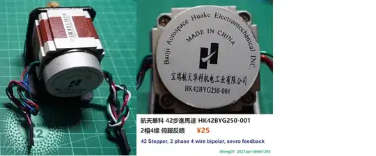

  1. Well, I can have my cake and eat it too, only for ¥25! : )
step motor with feedback
  1. For reading materials, I would recommend this newbie friendly tutorial:
    DC Motors and Stepper Motors used as Actuators - Electronics Tutorials
  1. For learning by getting your hands dirty, I would recommend to start with the very popular cheapy US$1 L298N DC Motor Driver Module. L298N can actually drive two DC motors and also one stepper motors, though there are better drivers for stepper motors, eg. A4988 Micro Stepping Stepper Motor Driver Module.
  1. For steer-by-wire motors, you might need big current drivers. I would recommend this also cheapy BTS2760/BTN7971B max 40A+ DC motor driver.
  1. I don't recommend to use or start with stepping motors, because they are too weak to drive cars, though they are very precise to do 3-D printing applications.
References
(1) AliExpress HK42BYG250-001 Stepper Motor NEMA17 | High torque 1.2A 38mm stepper motor for 3D printer 42 with speed feedback
