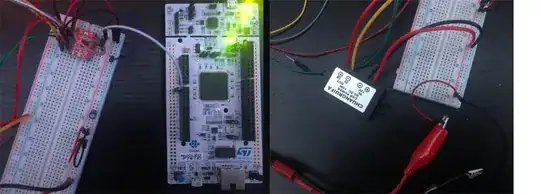

I am using an A4988 Stepper Motor Driver, which is controlled with an STM32F767ZI on a Nucleo 144 board. The stepper motor takes 12 V with a maximum of 350 mA.
When powered, the motor simply flickers and stutters, but moves at a negligible speed.

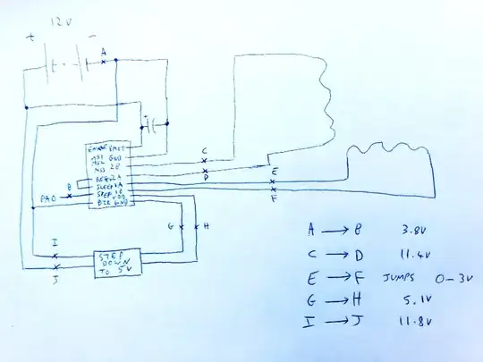

Here is a circuit diagram of the setup, with voltage readings taking from a multimeter:
The potentiometer has been set correctly.

    Do you have a datasheet for the stepper? The first thing to check would be that the phases of the stepper motor are correctly connected to the A4988 outputs. – gcr Apr 05 '21 at 02:36
    Are you sure 'stepMotor' function works to send a ~50% duty cycle PWM? – Ernesto Apr 05 '21 at 05:36
    @tlfong01 i have slowed it down, and the result is still the same – Starman Apr 05 '21 at 10:40
    @gcr i believe the only wiring concern with the motor is that one coil of the motor is connected to a number pair (1A with 1B, 2A with 2B), as outlined in this image (which is what I have done) – Starman Apr 05 '21 at 10:46
    @Ernesto nope, it doesn't. i was under the impression that any change to a high signal sent to the step pin of the A4988 would step the motor. i'll give this a go – Starman Apr 05 '21 at 10:50
  • I see from your schematic that you are using a bipolar stepper, but It is a bit difficult to follow you code to figure out your stepping sequence. It is not important which driver your are using, A4988, L298, 297, L293 etc. You might like to skim my answer to the following Q&A. Using L293D Motor Driver to Control Bipolar Stepping Motor 28BYJ48 - https://raspberrypi.stackexchange.com/questions/97975/using-l293d-motor-driver-to-control-bipolar-stepping-motor-28byj48. You might also follow the AdaFruit or other newbie friendly tutorial and let me know the stepping schemes you are using. – tlfong01 Apr 05 '21 at 11:35
  • You may like to refer to the newbie friendly Components 101 tutorial for a simple full step (no micro step) operation description. A4988 Stepper Motor Driver Module Tutorial - Components 101, 2019aug22 https://components101.com/modules/a4988-stepper-motor-driver-module. / to continue, ... – tlfong01 Apr 05 '21 at 12:34
  • It is not clear if you have a 2 coil, 4 coils, 4 wires, 5 wires, or 6 wires stepper. If you have a 6 wire bipolar, and if you wrongly select the wires, you might have strange movements. To make very sure you have selected the correct wires, you see that in my referred answer, I actually spent a couple of hours using a multi-meter and a battery and by hand (and later using a 2 pole 5 throw rotary switch) changed the polarity to actually see the motor stepping small steps of 1.8 degrees. To get a thorough understanding, you might like me, experiment DIY change bipolar to unipolar. configuration. – tlfong01 Apr 05 '21 at 12:47
    Are /Reset and /Sleep pulled to logic high somehow? – John Birckhead Apr 05 '21 at 13:35
    @JohnBirckhead the sleep pin is pulled up, so both reset and sleep are at logic high (which is intentional) – Starman Apr 05 '21 at 13:58
    Ok. We have a pull-up on our design. I couldn't find reference to an internal pull-up in the data sheet. – John Birckhead Apr 05 '21 at 14:06
    @user15278978: Check how long your "step" pulse is. The A4988 requires a minimum of 1 microsecond, with some restrictions on rise and fall time. Get an oscilloscope, and see what your "step" pulse really looks like. – JRE Apr 06 '21 at 14:57
    @JRE thanks, i'll have a look at that. i think my biggest confusion currently is whether the step pin is expecting PWM, or i can just set the output of a GPIO pin to high (i have occasionally seen people mention PWM, but have not seen anything about it in the datasheet)? – Starman Apr 06 '21 at 19:34
    @user15278978: All it takes is a pulse. One pulse = one step. The pulse has to meet the minimum requirements, though. – JRE Apr 06 '21 at 19:50
    @JRE gave that a go, but still not much luck. however, after taking some more readings with a multimeter and experimented with an LED attached to the same pin, it seems that it might actually be a problem originating from the Nucleo-144 board with the STM32 on it. i'll look into this further and report any updates on this. – Starman Apr 07 '21 at 00:05
    it appears the voltage output by the pin is not changing, and is stuck at around 1.6V both while the program is running and when it is paused, despite this pin being pulled down. and weirdly, it seems to run fairly smoothly but with big stutters at certain intervals when i hold the jumper wire in my hand – Starman Apr 07 '21 at 00:28

a4988 pic 1
a4988 pic 3
a4988 pic 2

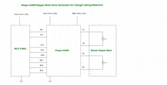

1. The MCU + Driver _ Motor Schematic V0.1
2. The OP's STM32 C++ Test Code Analysis
1. The MCU + Driver + Motor Schematic v0.1
schematic 1

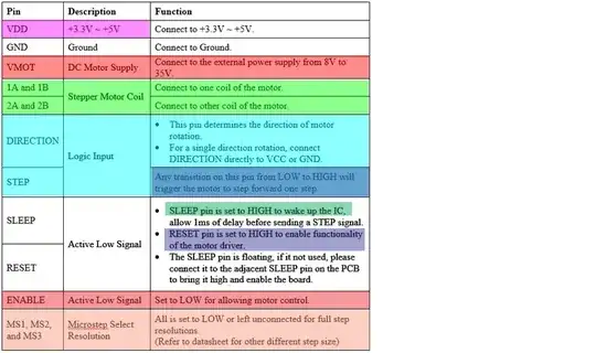

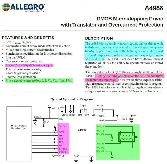

3.1 Now I am read the A4988 datasheet, checking out the operation and timing requirement, to make sure the timing of the OP's code is OK.
(2) A4988: DMOS Microstepping Driver with Translator and Overcurrent Protection - Allegro
a4988 spec summary

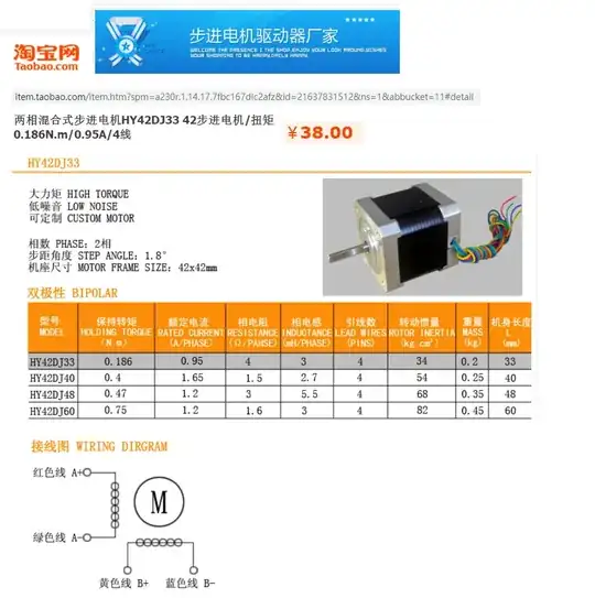

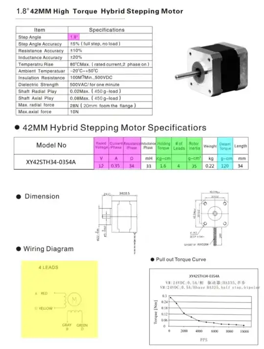

4. Specification of the OP's Stepper Motor
op stepper motor summary

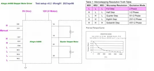

5. A4988 and Bipolar Step Motor Test Setup v0.2
5.1 WARNING: Do not connect or disconnect motor when A4988 power is on. Reason: motor coils are inductive devices. Back EMF when switch off coil current might fry A4988.
5.2 This basic test is for full step mode. Connect MS1, MS2, and MS3 to ground. Do not leave them floating, though datasheet says OK to do so.
a4988 test setup 1

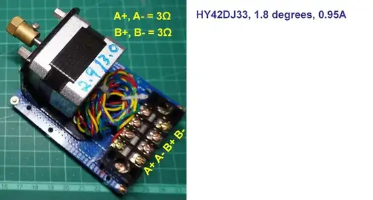

    6.1 I have wired up the stepper motor for testing. I checked the resistance and found them around 3R. If I power them with 12V, current would be 4A, and when disconnecting, might create a back EMF of perhaps a couple of time of 12V or around 30V+. I think to play safe, I should monitor the coil current and start with only 6V.
stepper motor resistance
  1. I found my two stepping motors good. So I moved on to the driver, and found the answer for the OP's question here.

Appendix E - HYU42DJ33 Steppeer Motor Spec
hy42dj33 spec
