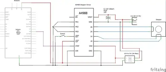

I've been stuck on this for a few days now and I can't seem to get my stepper to work.
Last week, I bought a stepper motor (nema 17 size, 1.5A) and an A4988 driver to play around with. I hooked it all up and was working great. The other day I decided to remove the pins from the driver and solder wires to it instead, which I don't think damaged it. When I hook everything up, the motor just vibrates and doesn't turn (It looks like it's moving a step forwared then one back constantly).
I've seen lots of similar questions on this site and none of the answers written there work for me. I have tried: switching the polarity of one of the coils, tested for continuity on the coils, tried a different power supply and grounded the MS pins (so that the driver is in full step mode).
I've got the driver configured to deliver about 1A to the motor and I'm using an arduino to control the step pin.
Below is my circuit digagram (Please Note, the switch is actually a toggle switch which either connects reset to ground or 5v, and the step pin of A4988 is actually connected to pin 9 on arduino):
Stepper Diagram

  • Please add a good photo of your setup - maybe we will catch something:) – Jakob Halskov Aug 05 '20 at 12:07
  • @Jacob Halskov I've added a link to some pictures. –  Aug 05 '20 at 12:42
  • Do you really have 5V connected to "Vin" on the Arduino? – JRE Aug 05 '20 at 13:46
  • Yes, 5v is connected to Vin –  Aug 05 '20 at 13:50
  • Well, that's a problem. Vin goes to a 5V regulator. If you feed 5V to a 5V regulator, you get less than 5V out and it isn't properly regulated. Your Arduino is running on less than 5V, and what it gets may be unsteady enough to cause the Arduino to reset. – JRE Aug 05 '20 at 14:32
  • Okay, would it be better to supply arduino with 12v? I was unaware that Vin was regulated –  Aug 05 '20 at 14:42
  • One option is to take the 5V output of your regulator and connect it to “5V” on your Arduino instead of the “Vin” pin. – Jakob Halskov Aug 05 '20 at 14:55
I ordered a new A4988 board and it arrived today, I switched out the old one with it and the circuit now works great.
The problem must have been a faulty/damaged board or a bad connection.
